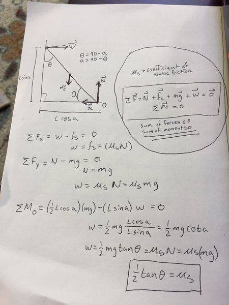

  • #38
In order to find the horizontal components of force: summing the moments about a point is the way to go.

Isn't this just a statics problem? Sum of forces and sum of moments must be zero if the ladder is resting on a wall and not moving.
Sum of forces (=zero)can allow the relation between the normal force exerted by the wall to the frictional force exerted by the ground(equal to the product of coefficient of static friction and weight).
Sum of moments (about the point on the ladder touching the ground;equals zero)can then allow you to relate the "wall" normal force to the weight of the ladder.
These two combined can give you an expression that relates the coefficient of friction to a geometric expression.
...I think. This is my first post here so I come before you as humble learner. I just read the problem and didn't think it was asking about a dynamic system (especially if OP is in the 10th grade and without calculus).

If you check back through the posts, you will see that the OP became intrigued by the dynamic frictionless problem and it's comparison with the static problem. I have tried to accommodate him as much as I can, given his limited mathematical background. This has not been easy.
