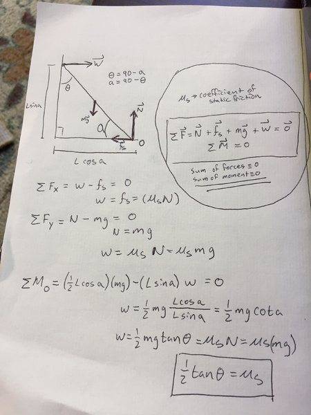

Hey everybody. I just took a test where a problem described, "a ladder is leaning against a wall with an angle of A. It has a length L and it weighs mg. Assume no friction against the vertical wall and a frictional coefficient of B, find Ffriction"
My dad, a quantum physicist, explained how the problem was done, saying that the normal force was mg because the forces in the Y direction added up to 0, the coefficient wasn't needed, and he used Torque (clockwise) = Torque (counterclockwise) to solve for Ffriction in a systems of equations. However, first of all, it wouldn't make sense that there was extra info in the problem, and second of all, I don't understand how the Fn could be mg if it was applied to the end (it just makes logical sense that if it is applied further from the weight center, it affects the translation force less.) I think he may be out of shape in terms of classical physics and forgot the exact way to do this problem and thus I'd like somebody to explain how to ACTUALLY do the problem.
What is the friction force that is needed to act on the foot of the ladder to ensure that the ladder doesn't fall down ?
It sounds to me like your dad's analysis is right-on. Have you drawn a free body diagram of the ladder?

yeah. the normal force is at the bottom of the ladder while the MG is at the middle (center of gravity) so how do those 2 cancel out? if you put a pencil on a table, pushing it in the center to make it translate if way easier than pushin on the edge because it rotates at the same time, so part of the force becomes rotational acceleration, right?

In your problem, there is no rotational acceleration. It is in static equilibrium. Do you believe that, for a rigid body in static equilibrium, you must have a balance of forces and a balance of moment? Yes or no?

I do. However, here what I've considered. If there were no side wall and the floor had no friction, what would happen is that the object would rotate & accelerate CCW but the center of mass would go downwards at the same time. That means the Fnormal is not as much as mg. Once you add the leaning wall, the F(leaning-wall-normal) will push the ladder sideways, but it still rotates and translates downwards. Only when the friction is added, another sideways force, then does the object reach equilibrium. So if the normal force wasn't enough to counteract the mg when there was no ground friction, why would it suddenly increase if you add a ground friction?
essentially what happens is that if there is no friction on the ground, the normal force causes the ladder to rotate and it also keeps falling. If there is a leaning wall, it does the same thing, except the wall will apply a sideways force on the ladder and make it translate sideways while rotating and falling at the same time (the sideways translation keeps the end of the ladder touching the wall in the same X-coordinate). But once the ground friction is added, the leader stops both rotating and translating.

that's what I'm trying to find out. the Ffriction on the ground. If you mean the leaning wall, it has no friction.

It doesn't suddenly increase. You are talking about two different problems.
This is all correct. So?
My recommendation is that you solve both problems so you can compare the results and get a better understanding of their relationship. It should be pretty interesting.
so the normal force is bigger if I add a frictional force sideways?

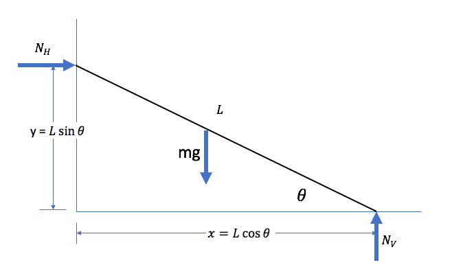

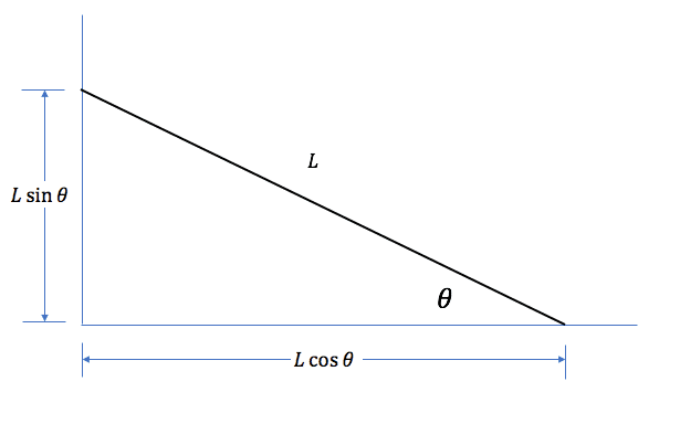

The first step in the analysis is to quantify the kinematics of the ladder motion. We will use the figure below to address that:
From the geometry of this figure, what are the x and y coordinates of the center of mass of the ladder (in terms of L and ##\theta##)?

but for the sliding object: the center of mass is at .5lsin(theta) and .5lcos(theta).

Excellent. Now, using these results, in terms of L, ##\theta##, and ##d\theta /dt##, what are the x and y components of the velocity of the center of mass?

The sliding motion of the latter is completely described once we know how the angle ##\theta## varies as a function of time t: ##\theta=\theta (t)##. The angular velocity of the ladder at time t, ##\omega(t)##, is equal to the rate of change of the angle ##\theta## with respect to time, and is represented symbolically (using calculus) by $$\omega = \frac{d\theta}{dt}$$The angular acceleration of the ladder at time t, ##\alpha(t)##, is equal to the rate of change of the angular velocity with respect to time, and is represented symbolically (using calculus) by $$\alpha=\frac{d\omega}{dt}=\frac{d^2\theta}{dt^2}$$
Using calculus, we can also obtain equations for the acceleration of the center of mass of the ladder in terms of the angular velocity and angular acceleration. We thereby obtain, for the horizontal and vertical components of the CofM acceleration, the following:
$$a_x=-\frac{L}{2}(\omega^2 \cos{\theta}+\alpha \sin{\theta})=-\frac{L}{2}\left[\left(\frac{d \theta}{dt}\right)^2 \cos{\theta}+\frac{d^2\theta}{dt^2} \sin{\theta}\right]$$
$$a_y=\frac{L}{2}(-\omega^2 \sin{\theta}+\alpha \cos{\theta})=\frac{L}{2}\left[-\left(\frac{d \theta}{dt}\right)^2 \sin{\theta}+\frac{d^2\theta}{dt^2} \cos{\theta}\right]$$
Notice that none of what we have done so far in any way relates to the original static equilibrium friction problem that you were solving. All of this is completely new and different. This is an indication of how very different the two problems are.
This completes what we wanted to do in terms of analyzing the kinematics of the ladder slippage. Now let's get to the dynamics. Please write down the Newton's 2nd law force balance equations for the sliding ladder in the horizontal and vertical directions, in terms of ##N_H##, ##N_V##, mg, ##ma_x##, and ##ma_y##.
(Note that this will not yet complete the dynamic equations, because we will also need a moment balance about the center of mass, involving the angular acceleration and moment of inertia of the ladder).
@jasonpeng : With respect, I feel that this analysis has gotten a little too complicated, even for a smart 10th grader like yourself. So I am going to fill in some of the intermediate steps, and then let you complete the solution for the reaction forces.
To simplify things, we will confine attention only to the initial state in which we first release the ladder to start sliding. At this initial point in time, the angular velocity of the ladder is zero, and the accelerations of the center of mass in the horizontal and vertical directions become:
$$a_x=-\frac{L}{2}\alpha \sin{\theta}$$
$$a_y=+\frac{L}{2}\alpha \cos{\theta}$$
where now ##\theta## is the initial angle of the ladder and ##\alpha## is its initial angular acceleration.
The Newton's 2nd law force balances on the ladder in the horizontal and vertical directions, and the moment balance on the ladder are given by:$$ma_x=-m\frac{L}{2}\alpha \sin{\theta}=N_H\tag{1}$$
$$ma_y=+m\frac{L}{2}\alpha \cos{\theta}=N_V-mg\tag{2}$$
$$m\frac{L^2}{12}\alpha=N_H\frac{L}{2}\sin{\theta}-N_V\frac{L}{2}\cos{\theta}\tag{3}$$
where ##m\frac{L^2}{12}## is the moment of inertia of the ladder about its center of mass.
Do these relationships in any way make sense to you?
