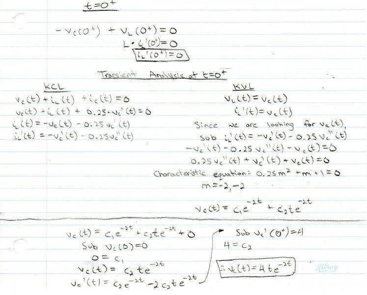

Here is the technique I am using:
[/B]

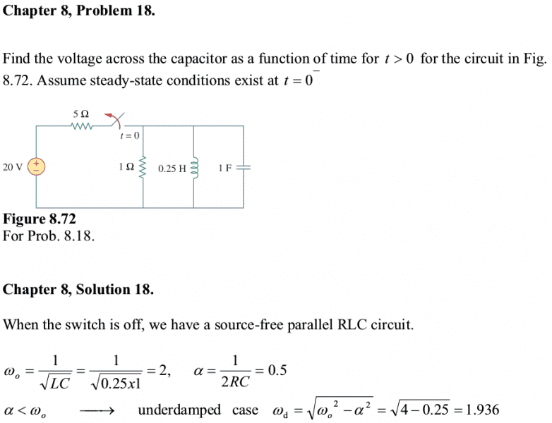

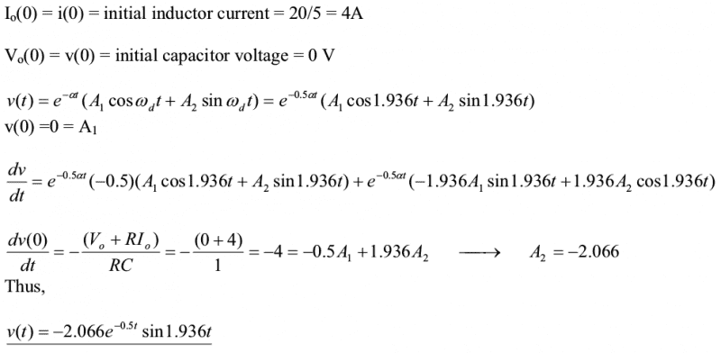

I understand how to solve the problem using the technique provided by the solution but I was wondering where I messed up in the technique that I used. I prefer the second technique because there is less memorization.
Did you have a question? The provided solution looks pretty thorough except that they didn't explicitly state the steady-state solution.

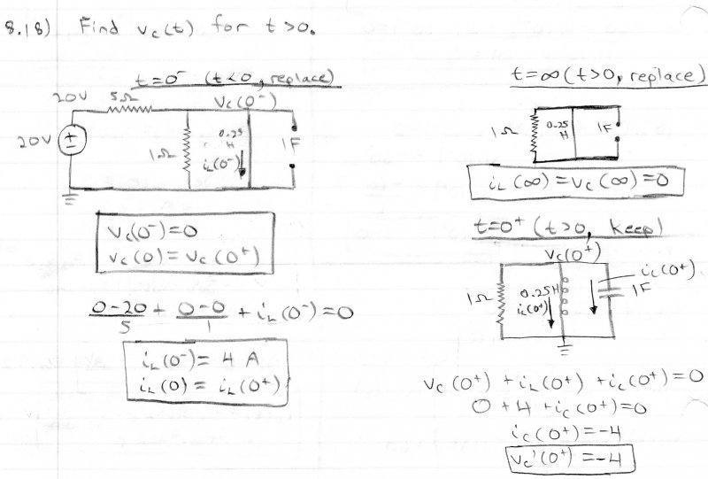

The problem is that the provided solution doesn't derive the differential equations from scratch. It uses equations that we are supposed to memorize. I would prefer to just solve the problem from scratch instead of plugging in and chugging. I am trying to derive the differential equations from scratch and I did so but my final solution is incorrect.
When I do nodal analysis I see:
$$\frac{v}{R} + \frac{1}{L} \int v\;dt + C \frac{dv}{dt} = 0 $$
Clear the integral by differentiating the whole thing:
$$\frac{1}{R} \frac{dv}{dt} + \frac{1}{L} v + C \frac{d^2 v}{dt^2} = 0$$
$$\frac{d^2 v}{dt^2} + \frac{1}{R C} \frac{dv}{dt} + \frac{1}{L C} v = 0$$
Plugging in component values and changing notation:
RC = 1
LC = 1/4
thus:
v'' + v' + 4v = 0
So you have complex conjugate roots, not a double real root. This makes sense since the circuit is underdamped.

I just did it this way and it seems to be correct. Is there anything I did wrong with my method?
Actually, I think I figured out what I did wrong. I substituted C=0.25 instead of C=1 and I substituted L=1 instead of L=0.25. Opps.
