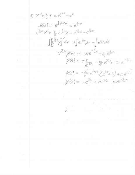

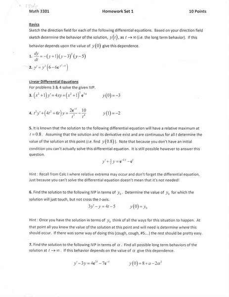

See uploaded file. PROBLEM 5
See uploaded file
I am confused on how to go about doing the rest of this I realize I can do it with the first and second derivatives but I forgot what exactly I do with that. I know the first derivative gives me a tangent line to the curve or should I use limits to do this? SEE PROBLEM 5
  • Handwritten solution to a first-order linear ODE: integrating factor u(t) = e^(∫(3/2)dt), then the integrated form and the solution y(t) = -(2/5)e^(-t) + (-(2/5)e^(3t/2)) + Ce^(-3t/2) with its derivative y'(t) below.
  • Printed homework sheet for Math 3301, Homework Set 1, listing differential equation problems 1 through 7 with initial value conditions, including the linear equation y' + (2/t) y = e^(-t^2) - e^t in problem 5.
I do not understand what you tried to do. The problem asks the numerical value of y at t=0.8.
What is the value of the first derivative at a local maximum or minimum? Substitute it for y' in the equation.

ok so should I scap my work or just plug .8 into the first derivative of what I did?
Answer my question, please. What is the numerical value of the first derivative of any function at a local extreme?
ehild
Ok man you got me I really am trying so at a local extreme there has to be a critical point so the value of the derivative at that point equals zero correct?
ok so by setting y'=0 and solving for y I get -1.34909.
Correct.
You can solve the differential equation, too (although it is not asked) and use this value of y at t=0.8 to get the integration constant. And then the full y(t) function is known.
