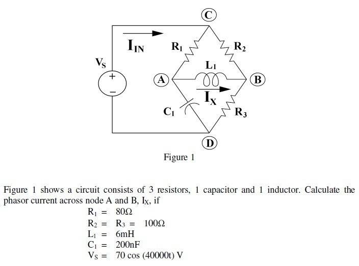

Hello, I have this question that I've been working on. The question requires me to find the current across an inductor in a Delta circuit, so I want to solve this question using Delta-to-Wye method. so I transformed it using the method and I found the total impedance of the whole circuit, then I divided the phasor voltage by the impedance and I found the current, but I still have no idea how I can find the current across the inductor. I attached a picture of the question so you guys can see my problem.
The result of the total impedance was around ( 82 - 64.07i)
and the phasor current after dividing by the phasor voltage is 0.6731 < 38
Thanks a lot, your help is really appreciated.

Say that you transform R1 R2 and ZL1 from delta to star. As you've found, you now have a series - parallel circuit that is amenable to "ladder style" collapsing. You do lose track of L1 in the process (it gets tangled up with R1 and R2 in the transform), more importantly however you do still have access to nodes A and B.
So you can calculate the voltages at A and B from the transformed circuit, then using this knowledge of [itex]V_{AB}[/itex] you can then go back to the original circuit to solve for Ix

If you apply a Δ-Y transform to the circuit you will "transform away" the component through which you want to find the current (L1). However, nodes A and B still exist in the "new" layout, so you could calculate their node voltages. With the two node voltages in hand you can go back to the original layout to determine the potential difference across L1 and hence its current...
A more straightforward approach might be to write KVL mesh or KCL node equations for the original circuit.
