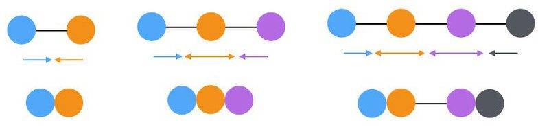

Imagine exactly same two bodies (same mass, same surface/friction etc) are attached with a string/spring and they suddenly start pulling towards each other with equal force. I can imagine they will move towards the center. If there is a chain (with defined number; not infinite) of such bodies attached to each other and each body starts pulling towards each other then would whole system shrink towards the center or just the bodies at the terminal ends because rest of the bodies are experiencing equal and opposite forces. I am stuck.

Are these in a straight line? Consider one of the masses at either end. What forces are acting on these? Which direction will they move? Could you make a free body diagram for each one to get the net force on each one? Start with 2. What about 3, 4. Is there a pattern?

Thanks, I have considered most of them already and showing here in image . Arrows show forces direction. Still I think only terminal bodies will move. Not sure though if am missing any other aspect.

Are there external forces acting on any component of the system of masses?
Can the center of mass of the system accelerate if no external forces act on any of the masses?

Look at the figure on the lower right. You have four masses that can be considered as two masses ##2m## pulling on each other. Will they stay where they are or move together?
Yes they should shrink towards each other 'if' forces are acting constantly. 'But' the way I was thinking that forces are applied at the same and for one instant only then goes off.
Again, yes they will move towards each other but now as the mass is increased the displacement would be less (halved in this case). So if constant force keeps on acting then can I say that the system starts shrinking from outside towards the inside?

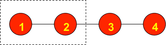

Say you start with a linear chain of 4 equal masses and equal constant forces between adjacent pairs of masses. Mass 1 experiences a net force to the right. So the distance between 1 and 2 will decrease. However, you can consider masses 1 and 2 together as a system acted upon by an external force to the right due to the system consisting of masses 3 and 4 (see figure below). So the distance between 2 and 3 will also decrease. By symmetry, the distance between 3 and 4 will decrease just like the distance between 1 and 2. All separations between masses decrease at the same time. A visual demonstration of this would be to zoom out your screen while watching the figure below. Concentrate on the separations between circles and pretend that the diameter of the circles stays the same.

Say you start with a linear chain of 4 equal masses and equal constant forces between adjacent pairs of masses. Mass 1 experiences a net force to the right. So the distance between 1 and 2 will decrease. However, you can consider masses 1 and 2 together as a system acted upon by an external force to the right due to the system consisting of masses 3 and 4 (see figure below). So the distance between 2 and 3 will also decrease. By symmetry, the distance between 3 and 4 will decrease just like the distance between 1 and 2. All separations between masses decrease at the same time. A visual demonstration of this would be to zoom out your screen while watching the figure below. Concentrate on the separations between circles and pretend that the diameter of the circles stays the same.View attachment 227758
Not so.
The mass centre of the 1+2 system will move to the right, but that will be entirely down to the fact that mass 1 is moving to the right. If all tensions are equal and constant then mass 2 will not move until mass 1 reaches it.
This is counterintuitive because real springs do not maintain constant tension. In practice, as soon as mass 1 has moved a little mass 2 will accelerate.

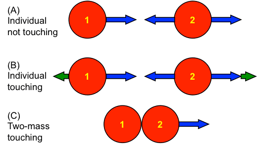

haruspex said:
Not so.
I agree. When I posted #9 I mentally switched to springlike forces.
Consider the (unrealistic) model of a constant force between adjacent masses and the FBD of a system being a "standalone" mass having a non-touching neighbor on either side. Below I show
(A) two separate FBDs of each mass when they are not touching. The accelerations are ##a_1=\frac{F}{m},~a_2=0##.
(B) two separate FBDs of each mass when they are touching. There is an additional contact force ##N## (green arrows) acting on each mass.
(C) a single FBD of the two-mass system. The forces in it are the vector sum of the forces in the two (B) diagrams.
From (C) the common acceleration, also the acceleration of the cm, is ##a_{cm}=\frac{F}{2m}##. Then from either diagram in (B) the magnitude of the contact force is ##N=\frac{F}{2}##.
So it looks like, under this model, the chain collapses from the ends in because mass 2 does not accelerate until it is touched by 1.
Hi All,
I think we do have different explanations but we agree, and as nicely summarised by kuruman above, that shrinking starts from the terminal ends. I had been trying to explain this to my friends but no one agreed. Thanks kuruman, scottdave, haruspex, fewmet and PF for getting involved in the discussion.
