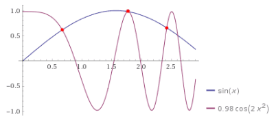

Task
Use the Bisection, Newton, and Secant methods to solve (to at least 8
signicant figures) the equation
sin(x) = 0.98 cos(2x2)
over the interval [0, 2.5], in radiant units. For the Newton method, try with
several different initial guesses including x0 = 1. With the Secant method,
use the same initial values as for the Bisection, as well as other appropriate
values. Comment on the results by comparing the effectiveness of
each method for this problem. In particular, compare the number of iterations
required by each method to find the solution to a specied accuracy
(at least|f(xroot)| ≤ 10−6
), and see if the behavior you observe tallies with
theoretical predictions where they have been given, in particular the order of
convergence. Provide a careful explanation on your observations.
Hint
Draw a graph of the equation to understand the behaviors of the equation,
such as the number of solutions and the locations of the roots.
p/s: basically i don't even know what this question want exactly, i do try my best to understand it but i cant. I am sorry
Well, the hint says to start with a plot, which is also what I would do. What do you get for that?
i don't know how to start plot the graph actually.
Hey lunia, welcome to MHB! ;)
For quick reference, you can copy and paste your formula into Wolfram|Alpha.
The graph looks like this:
Can you tell what the number of solutions is now?
And what the locations of the roots are approximately?
tbe number of solutions is 3.
locations of the roots are approximately: 0.7, 1.8 and 2.4.
did you just copy the exactly same like the formula or how did your write it? i didn't get it yet
Looks about right.
Couldn't there be 2 roots around 1.8 though?

I copied and pasted [M]sin(x) = 0.98 cos(2x2)[/M] into https://www.wolframalpha.com, which shows most of what you might want to know about that equation.
After that I refined it into [M]plot[sin(x) = 0.98 cos(2x2), {x, 0, 2.5}][/M] to get just the graph on the interval [0, 2.5].Anyway, to apply Bisection or any of the other methods up to 8 significant digits, you will need to use a computer or some other type of calculator.
