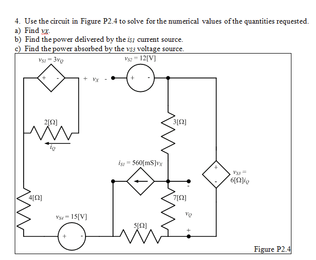

I am asked to solve for vX, PDEV BY iS1, P ABS BY vS3 (please see attached figure). We have only covered KCL, KVL, Ohm's law and Power in class. No Thevinen theorem, so it can't be used to help solve.
I know that current will not pass through the 4 Ohm resistor or vS4. My initial hunch was to solve for iQ in terms of vS1 (upper left of figure) and then use that equation to help solve for a KVL with the 3 and 7 ohm resistors and vS3. The result was not pretty and very wrong.

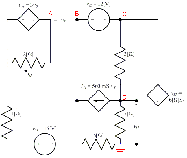

Yeah, it's going to get messy. There are a lot of interrelationships to account for with all the controlled sources. However, to make a start, choose a ground node, label the other important nodes, and see what you can do about writing equations for their voltages in terms of the given information. Here's a suggestion:
Circuit schematic with dependent voltage source vS1 = 3vQ, independent sources vS2 = 12 V and vS4 = 15 V, dependent current source iS1 = 560 mS vX, dependent voltage source vS3 = 6 Ω iQ, and resistors 2, 3, 4, 5 and 7 ohms; nodes A, B, C and D labeled.
The voltage at node D (which is the same as -vQ) will be important. You can write a KCL equation for that node.

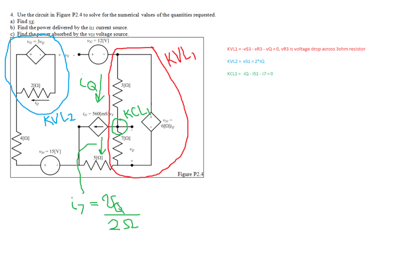

Here's what I have so far. Unfortunately, I keep running into nonsensical, trivial answers where my systems keep having coefficients of zero. :confused: I've spent several hours on this problem.
  • Circuit schematic labelled Figure P2.4 with dependent sources vS1 = 3vQ, vS2 = 12 V, vS3 = 6[Ω]iQ, iS1 = 560 mS vX, vS4 = 15 V, resistors 2, 3, 4, 5 and 7 ohm, and handwritten KVL, KCL and i7 = vQ/2Ω annotations.
Watch out for the polarities of things. The diagram shows vQ to be the negative of the voltage at your KCL1 node (note the +/- sign locations).
Suppose you take the voltage at node D to be vD. Then [itex]v_Q = -v_D[/itex]. Can you write expressions for the node voltages at A and B (with respect to the ground node that I indicated) in terms of this vD ? (You may need to keep vx as a variable for now).
