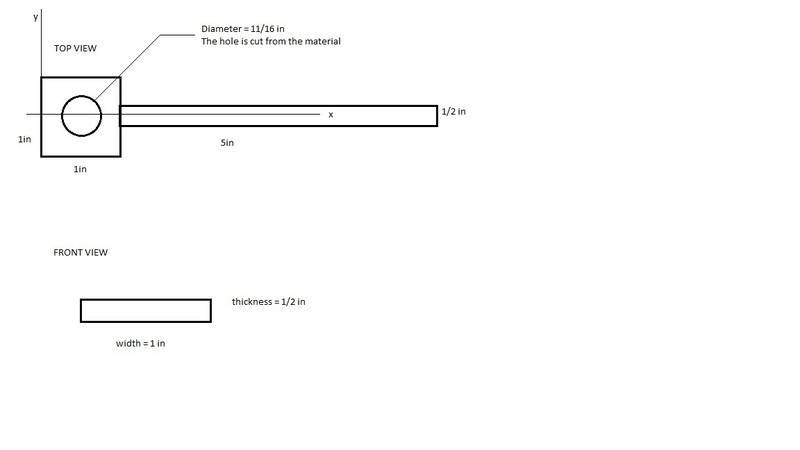

I'm having a problem calculating the I value for this beam. I'm not sure on how to account for the missing circle in the front square and how to account for the beam changing from a 1" x 1" square to a 5" x 0.5" beam
Ixx = bh^12/12
The centroid of the beam is around x = 2.89711 in
The thickness of the beam is the same and so is it's density
Here is a picture of the beam
**If there was no missing circle, could I just add I_square + I_rect = I_total? **
  • Engineering drawing of a beam with a top view and front view. Top view: a 1in square end with a hole of diameter 11/16 in cut from it, attached to a 5in long bar 1/2 in wide; x and y axes shown. Front view: a rectangle labelled width = 1 in and thickness = 1/2 in.

First thing, just get I for the square (with no hole in it) and then subtract the I for a cylinder. That will give you the I for the shape.
Second thing: The I that you get will be about its own centroid, not the centroid of the beam. So you need apply parallel axis theorem for the square (with the hole) and the rectangular section before you add them up.
Do you want the I about the x-axis, or the y-axis? If about the x-axis, the parallel axis theorem as suggested by rockfreak does not apply. You made a mistake in your formula for Ixx in post #1. Can you see what the error is?
EDIT: Pongo is right, forget my parallel axis thing, I keep substituting I with J.
