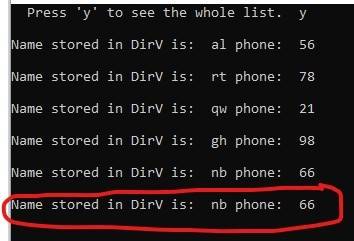

I have been working on the program, yes, I am still crawling in C++, but after I worked on the program, the program is not exactly running material. I say it's at best slow walk. I manage to using the Constructor in the .h file to check for file existence, if not, create an empty file. In main, I have option to create the new file or read back the existing names.
This is a much simplified version that each name structure has only name and phone number. I can create as many name as I want in the directory. So far, the option is to read them all back. Displaying particular name, add new name or delete name will come later. But the structure of the program is done already. Doing the sorting, adding, deleting should be quite easy. In the whole C++, the sorting so far is the easiest part for me. So I am not worry about it.
Of cause, this is the first time I wrote such a complicate program, I am sure it can be improved quite a bit. Any suggestion is very welcome. I want to push what I learn so far, this program sure did pushed me. I spent a lot of time searching on line to look at how people do things also. Here is what I have. It's is NOT a big program so far.
I still believe in doing as few interfacing with the file as possible. Not only it's slower, hard disk and flash memory have finite working cycles. I don't want to do all the searching, sorting stuff directly on the file. What I do is download the entire file to the vector DirV in the Constructor, the rest of the program is just working on the DirV until closing the program. The Destructor then write the entire content of the vector DirV back into the file. So one read and one write to the file every time I open the program.Here is the .h file, I use inline function instead of creating a separate implementation file:

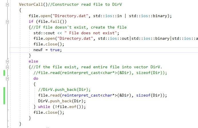

In your constructor you have this code -
C++:
    else
        {//If the file exist, read entire file into vector DirV.
          file.read(reinterpret_cast<char*>(&Dir), sizeof(Dir));
          do
            DirV.push_back(Dir);
          } while (!file.eof());
          file.close();
Why are you calling read() twice?
I think the better question is why is he calling it once? The job of the constructor is to construct the object, not to run all of the code, He shouldn't be reading files in the constructor and he sure shouldn't be writing them in the destructor.
The same thought occurred to me, about what the job of a constructor should be.
The destructor behavior is far, far worse. Suppose you call the constructor, do some running, and then decide that the in-memory copy is not what you want. Maybe it's even corrupted. Now what? If you destroy the bad object, it overwrites the good copy. If you decide to exit without writing, you implicitly call the destructor anyway and still manage to overwrite the good copy

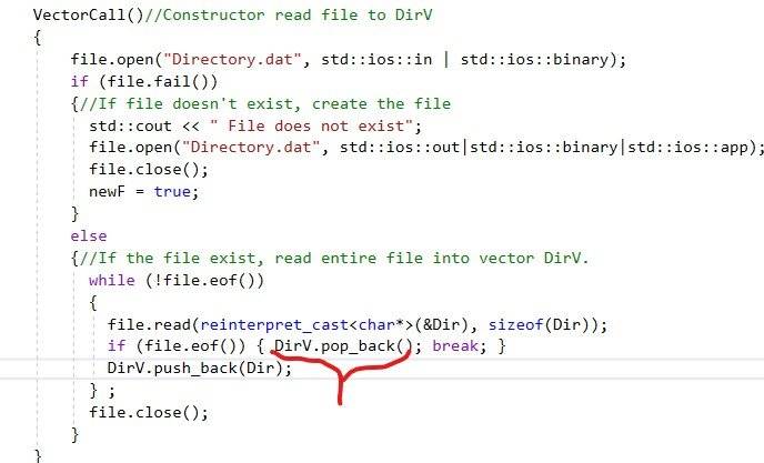

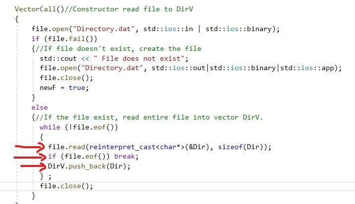

Not being a C++ programmer, I had to spend 30 seconds with Google to learn about the break statement.
Also, not being a C++ programmer, I'd missed the difference between "do {block} while (condition)" and "while (condition) {block};

Thanks for the suggestion. The reason I wrote the read like this is because I ran into problem reading the last element twice before. I did talk about this here and I wrote down in my notes to do this. Maybe this doesn't matter, but I don't want to take the chance and just put one more line.
Thanks
It's not just bad form. It is actually wrong as written. What if you are reading from an empty file?

This is the result, the last line is repeated.
Terminal output listing 'Name stored in DirV is' lines with names and phone numbers, the last entry 'nb phone: 66' repeated and circled in red.
I have to think of some other way to fix this if I have to eliminate one read. BUT still, that doesn't help reading an empty file. The first read will read empty file.

I tried your suggestion:
C++ code excerpt from a VectorCall constructor that opens Directory.dat, creates it if missing, then loops with while (!file.eof()) reading records into DirV, with red arrows marking the read, the eof break check and the push_back call.
It still print out the last line twice.
I wish I can find the thread that we talked about this, it's tricky. The eof() does not become true right away and double write the last data.
