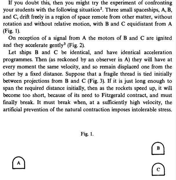

"Suppose that a fragile thread is tied initially between projections from B and C (Fig. 3). If it is just long enough to span the required distance initially, then as the rockets speed up, it will became too short, because of his need to the Fitzgerald contract, and must finally break. It must break when, at sufficiently high velocity, the artificial prevention of the natural contraction imposes intolerable stress".
Then, I should had to comment that "fragile" in the Bell's sense means that the string has really no ultimate tensile strength, and so, will break at any tension. And then, for this alternate scenario, remark that I do consider a real string, although with a very weak ultimate tensile strength in relation to the scale of the mass of the spaceships.

Lluis Olle said:
spaceship's engines with constant and same F/M ratio (being F the propulsion force), instead of a constant and same proper acceleration
This is not a good description of what you are changing. The key point you appear to want to make is that the string exerts a non-negligible force on the spaceships, whereas in Bell's formulation of the scenario, it doesn't. That is the change you need to specify. Talking about the spaceship engines is irrelevant since the specification for what they do does not have to change at all from Bell's scenario in order to investigate what you say you want to investigate.

PeterDonis said:
My point is that the "thrust" part is unchanged from Bell's original scenario.
No. Bell’s original scenario specifies “identical acceleration programmes” and “fragile thread”:
With the fragile thread “identical acceleration programmes” is the same as “same F/M ratio (being F the propulsion force)”. But with a non-fragile thread “identical acceleration programmes” differs from “same F/M ratio” because now the differing tension forces produce different “acceleration programmes” given the “same F/M ratio”. The OP indeed needs to include both changes for the scenario they are considering.
I would like to remark that no string was hurt during this post, as it was only a "what if...".
Thanks Dale.
I think that depends on what Bell meant by "identical acceleration programmes". I think he meant "same F/M ratio". In other words, he was specifying what the spaceships' engines were programmed to do: put out the same constant F/M. Note that Bell specifies "identical acceleration programmes" before he even mentions the fragile thread. So he seems to me to be specifying "identical acceleration programmes" to be what it would be in the absence of any thread or any other connection between the spaceships, i.e., to be same F/M ratio.
To put it another way: if we compare Bell's original scenario with the OP's scenario, do the spaceships' engines do anything different? I think the answer is no; more to the point, I think the OP thinks the answer is no.
I think the OP agrees with @Dale:
"So, which's the morale of this short fiction piece? if you consider written into stone that the proper acceleration of the spaceships is always constant - which is the statement of the Bell's paradox -, then it's all said. To keep always a constant proper acceleration, means that the spaceships engines will exert whatever the force is needed to do that. And then, the "weakness" of the string is irrelevant, because any non-infinite ultimate tensile strength string breaks."
That has also been my interpretation of Bell in the case where one claims any string will eventually break - this means that thrust force will need to increase to compensate for string tension to maintain constant proper acceleration.
For the scenario stated as given in what you quote, I agree. I just don't think that is the same scenario as Bell's original scenario. See below.
But, as has already been shown, Bell's original scenario did not claim that "any" string will eventually break. His original scenario specified a "fragile" thread. As @Dale said in an earlier post, "fragile" implies zero (or at least negligible) tensile strength, which in turn implies zero (or at least negligible) effect on the rockets' motion without the rocket engines having to make any compensation for string tension.
I agree that if we extend his original scenario to apply to any string whatever and specify that proper acceleration remains constant under those conditions, then obviously the rocket thrust needs to increase to compensate for increasing string tension until the string breaks. One way to explain why that is possible in principle would be to observe that, while relativity puts a finite limit on the tensile strength of materials, it does not put a finite limit on rocket thrust or proper acceleration.
Perhaps the upshot of this is that Bell's original scenario is ambiguous as to how it can be extended to conditions beyond what he originally specified.
