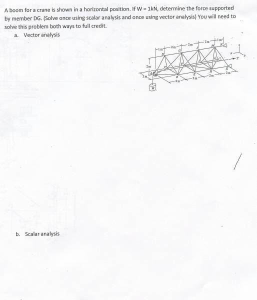

To solve a 3-D truss problem, it is essential to apply the equations of equilibrium: ƩFX=0, ƩFY=0, and ƩFZ=0. The vectors for points B, C, and D have been identified as rB(2i,-1j,0), rc(2i,1j,0), and rd(1i,0,2k), but confirmation of their accuracy is needed. The discussion emphasizes the importance of a clear frame of reference and suggests that the applied forces and member DG are confined to the xz plane, which simplifies the analysis. It also raises the question of how many equations of equilibrium are necessary for a complete solution in three dimensions. Understanding how to express the moment of a force using vector notation is crucial for progressing further in the problem.

I figured out rB(2i,-1j,0), rc(2i,1j,0),rd(1i,0,2k) can you check if my vectors r right. After find the vectors of point B,C,D I calculated the unit vector, not I am stuck I don't what other information i need to find force at DG, need directions.

You haven't declared your frame of reference, but it is implied by your equations, which are credible (rather than being 'right'). Your three relevant equations are for a two-dimensional situation. You can solve the problem by recognising that the applied forces and DG all lie in the xz plane, but if you are expected to solve the problem unnecessarily in three dimensions, how many relevant equations of equilibrium are there? Do you know how to express the moment of a force, using vector language?
