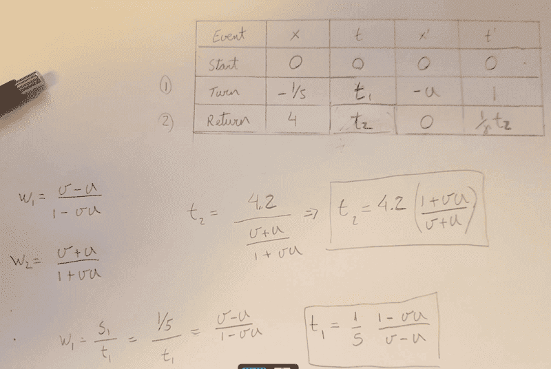

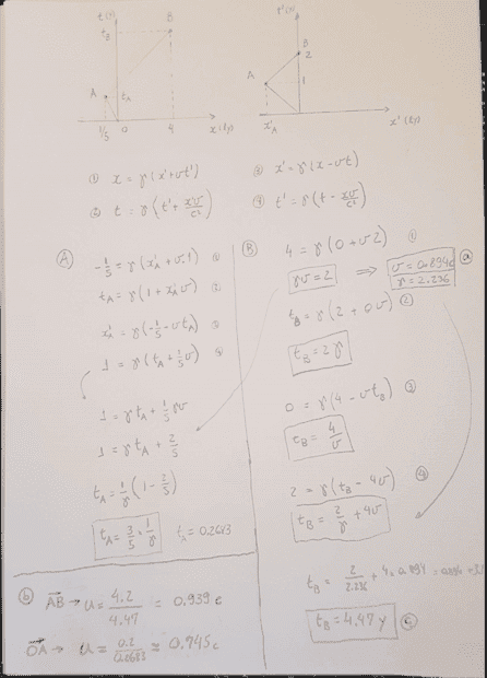

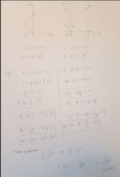

I am still struggling so I will post what I have so far...
Are these correct?

You should be able to write down ##t'_2##.
I don't think you'll get a solution very easily using velocity transformations. Lorentz transformations are the way to go. I might have said that already.
Ibix said:
A table like this might help:$$\begin{array}{|l|c|c|c|c|}
\hline
\mathrm{Event}&x / \mathrm{ly}&t/ \mathrm{years}&x'/ \mathrm{ly}&t' / \mathrm{years}\\
\hline
\mathrm{Rocket\ leaves}&0&0&0&0\\
\mathrm{Rocket\ turns\ around}&-1/5&&&1\\
\mathrm{Rocket\ returns}&4&&0&\\
\hline
\end{array}$$
I find spacetime diagrams really helpful as well to keep things straight.
event O = rocket leaves
event A = rocket turns around
event B = rocket returns
As @PeroK noted, it should be pretty clear what ##t'_B## (PeroK's ##t'_2##) is equal to from the diagram on the left.
Spacetime diagrams are an excellent tool.
@R3ap3r42 - the point with the Lorentz transforms is that you can use them to complete each row of the table in terms of ##v## because in each case you know two things, ##x## and either ##x'## or ##t'##. The Lorentz transforms are two equations, and there are two things you want to know..
Only at that point do you bring in the fact you've already observed, that ##x'## at the turn around is ##u\times 1##. You'll also need the value of ##t'## at the return, which you should be able to deduce). Then you can solve for ##v## then ##u##.

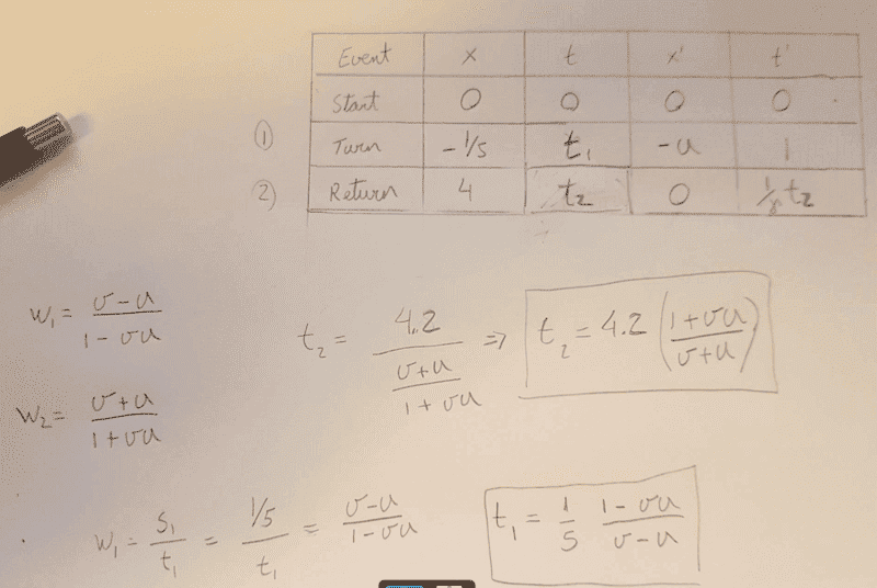

OK, this helps a little more.
I was happy for a minute there until I got again to something wrong...
Where did I mess it up this time?
