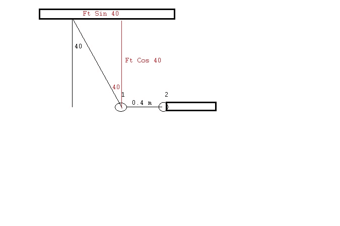

Charge 1 (0.15 kg) in the following diagram is hanging from a light insulating thread, as shown in diagram (red is what I have added myself)
Charge 2 is brought close and pulls charge 1 , deflecting the string away from the vertical axis by 40 degrees. The charges have the same magnitude, charge 1 is negative.
A) Find the tension in the thread
B) Find the charge on 2.

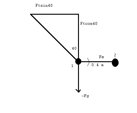

Fg=mg
Fe=Kq2/r2
Vertical
Fnet=0
0=FtCos40 + (-mg)
Ft=mg/cos40
Ft=1.92
Horizontal
Fnet=0
0=Fe+(-Ftsin40)
0=kq2/r2+(-1.92sin40)
q=√(1.92sin40)(0.42)/(9x109)
q=+/- 4.7x10-6C
How does this look?

the answer q=+/- 4.7x10-6 C is not correct. Read the problem again. It says
Do the charges attract or repel? What is charge 2 then?
ehild
Well I wrote +/- because it was a square root, the charge is actually positive I know because it attracts charge 1
Thank you for the input however I feel more confident with my physics knowledge everyday !
Then it was correct but it was not the solution yet.

It was a nice solution. I especially liked the picture. You can be confident in your knowledge! :smile:
ehild
It is common for the math to give a choice of solutions - you pick the one that makes sense in terms of the physics.
