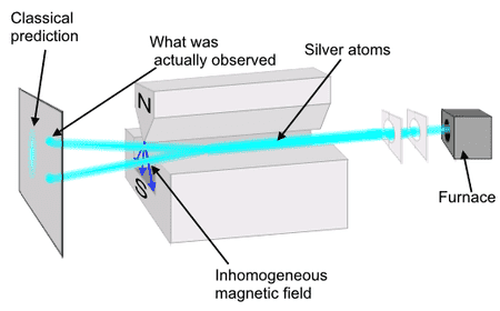

What exactly entangled-spin pairs do in Stern–Gerlach experiment that ordinary particles pairs with opposite magnetic dipole moments do not?
There is a subtle problem with the way you've asked this question. A quantum mechanical property like spin has no definite value until is measured, so when you say "a particle pair with opposite magnetic dipole moments" you're really saying "a pair of particles that we just measured on the same axis and found one to be up and the other to be down". Unless and until we've made that measurement, there's no such thing as an "ordinary particle pair with opposite magnetic dipole moments".
The difference between an entangled pair and a non-entangled pair is that we know that if we measure them both on the same axis, we will always get opposite results with an entangled pair but we won't always get opposite results with a non-entangled pair.

I understand QM interpretation. I don't understand what is supposed to be classical interpretation and how are they different.
There's no such thing as an "ordinary particle pair with opposite magnetic dipole moments"? Is there some reason we can not make neutrons orient their magnetic moments in a specific desired direction and then send them off to be measured?
If we send today 100 neutrons to Alice each of which with definite magnetic moment orientation (Xi,Yi,Zi) that we select at random, and if tomorrow we send 100 neutrons to Bob each of which with definite magnetic moment orientation (-Xj,-Yj,-Zj), then how are we not supposed to always get opposite result for i=j pairs if we measure them along the same axis?
We can. We take a beam of neutrons and pass them through a S-G apparatus oriented in a partcular direction, and then if we only want the spin-up direction we only use the neutrons in the part of the beam that was deflected upwards. But that's a measurement; the things did not have any orientation before then (and that is actually an experimentally verifiable fact - google for "Bell's Theorem" and "Alain Aspect").
There is no way of producing a beam of neutrons that is known to be in a particular spin orientation without somehow "processing" them to get them into the desired state. The neat thing about entangled particles is that no matter what orientation we process one member of the pair into, we know that a measurement of the other member will produce the opposite result; in effect we're always "processing" the entire pair.
Let's say I want to produce two beams of neutrons, both spin-up, but going in opposite directions. So I set up two S-G devices, one on each side of my neutron source, orient them both vertically, and then block off the downwards-deflected beam from both. If my neutron source is generating entangled pairs, then I will never (except by random chance when multiple pairs arrive at the SG devices at the same time) find a neutron passing through the left-hand device at the same moment that a neutron passes through the right-hand device. Many neutrons will make it through the left-hand SG device, and many neutrons will make it through the right-hand device, but for each pair, only one member will make it through.

I didn't take it seriously enough, but it was suggested previously that officially classical physics already fails with the simplest Stern–Gerlach experiment and only one analyzer. If there is no classical answer for that, then there is no point going any further.
What a surprise. But that doesn't sound right, how did anyone come up with the idea that classically those silver atoms would just bunch up around the middle as if there isn't any external magnetic field at all?
I think proper classical modeling would show bunching up and down just as is measured. I think both up and down silver atoms would actually end up with their magnetic north pole aligned vertically downwards, and so whether they will go up or down would depend more on their initial position and direction when entering the external magnetic field than on their original magnetic dipole orientation. Wouldn't it? This is completely different than what I originally thought, but I don't see anything else would classically even make any sense at this point.
  • #31
You are misunderstanding that picture. The "classical prediction" doesn't show the atoms bunching up in the middle as if there were no external magnetic field, it shows the atoms spreading out in the direction of the field as some of them are deflected more than others.
That's what classical E&M predicts, and it's how larger charged rotating objects behave in an inhomogeneous magnetic field.
No. The classical analysis says that when the particles first enter the field they are subject to very different forces according to the direction of their initial magnetic moments. That causes them to spread out initially. Even if they eventually align themselves with the field, by then they're already spread out.
Ok, but that's not much better. Would you agree how much the two bunches separate depends on particles velocity?

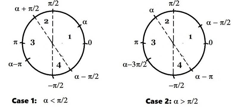

A few more details about the linear model.
The proposed rule for Alice's outcome A(\vec{a}, \vec{S}), where \vec{a} is Alice's orientation, and \vec{S} is the hidden variable (a spin vector), is this:
A(\vec{a}, \vec{S}) = sign(\vec{a}\cdot\vec{S})
where sign(x) is +1 or -1 depending on whether x is positive or negative.
Bob's outcome B(\vec{b},\vec{S}), where \vec{b} is Bob's chosen orientation, is the opposite:
B(\vec{a}, \vec{S}) = sign(\vec{b}\cdot\vec{S})
Now, we can characterize a vector \vec{S} by two numbers: \theta = the angle between \vec{S} and the projection of \vec{S} onto the planet containing \vec{a} and \vec{b}, and \phi, the angle between the projection of \vec{S} onto that plane and the vector \phi. To compute A(\vec{a},\vec{S}) and B(\vec{b},\vec{S}), only \phi is relevant. (There are a few cases for which \theta and/or \phi is undefined, but let's ignore those, since they are a set of measure zero.)
Let \alpha be the angle between \vec{a} and \vec{b}. There are two cases to consider:
Case 1: 0 < \alpha< \pi/2
Case 2: pi > \alpha> \pi/2
As shown in the figure, in Case 1, there are 4 regions of interest:
  1. \alpha - \pi/2 < \phi < \pi/2. In this region, A(\vec{a},\vec{S}) = +1 and B(\vec{b},\vec{S}) = -1
  2. \pi/2 < \phi < \alpha + \pi/2. In this region, A(\vec{a},\vec{S}) = -1 and B(\vec{b},\vec{S}) = -1
  3. \alpha + \pi/2 < \phi < 3\pi/2. (Note: 3\pi/2 is the same angle as -\pi/2). In this region, A(\vec{a},\vec{S}) = -1 and B(\vec{b},\vec{S}) = +1
  4. - \pi/2 < \phi < \alpha -\pi/2. In this region, A(\vec{a},\vec{S}) = +1 and B(\vec{b},\vec{S}) = +1
In regions 1 and 3, A(\vec{a},\vec{S})B(\vec{b},\vec{S}) = -1
In regions 2 and 4, A(\vec{a},\vec{S})B(\vec{b},\vec{S}) = +1
If \phi is chosen randomly, then the fraction of time that it will be in regions 1 or 3 is given by: P_{1,3} = \dfrac{2(\pi - \alpha)}{2\pi} = 1 - \dfrac{\alpha}{\pi}
The fraction of time that \phi will be in regions 2 or 4 is given by: P_{2,4} = \dfrac{2\alpha}{2\pi} = \dfrac{\alpha}{\pi}
So the correlation E(\vec{a}, \vec{b}) is -1 \cdot (1 - \dfrac{\alpha}{\pi}) + 1 \cdot \dfrac{\alpha}{\pi} = -1 + \dfrac{2\alpha}{\pi}
The case with \alpha > \pi/2 can be figured out analogously, but I'm too tired to do it.

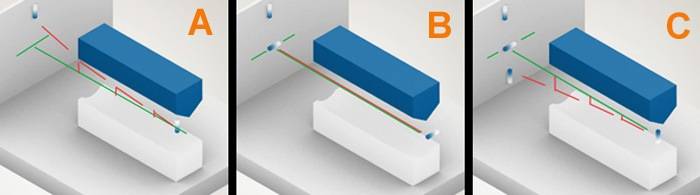

Tracked down how's classical prediction supposed to work out:
http://www.toutestquantique.fr/#magnetisme
So it is assumed magnetic dipole orientation would somehow stay fixed along the whole journey through the external magnetic field. That's not what I see when I experiment with my magnets, the first thing they seem to want to do is to rotate in alignment with an external field. Based on what physics would anyone expect the little magnet on B and C image would not flip its south (white) pole upwards towards the external north (blue) pole? Also, if the magnet on image A started at a bit lower position, would it not get attracted downwards throughout its whole trajectory and end up below the center green line?
This is because, as I said earlier, both the velocity of your magnets and the gradient of your magnetic field are many orders of magnitude too small to produce the effect that you're looking for.
You've missed something important here - this an inhomogenous magnetic field and the gradient, which is what matters, points in same direction on both sides of the center green line. So the direction of deflection for a given magnetic moment is the same.
