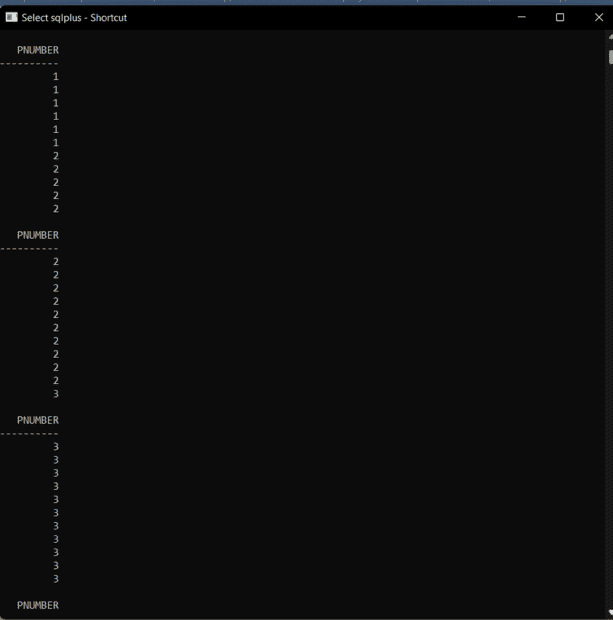

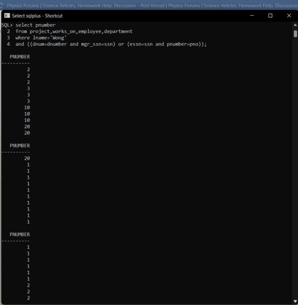

I am trying to understand how sql query selects multiple times the same value when I use a combination of condition in where.

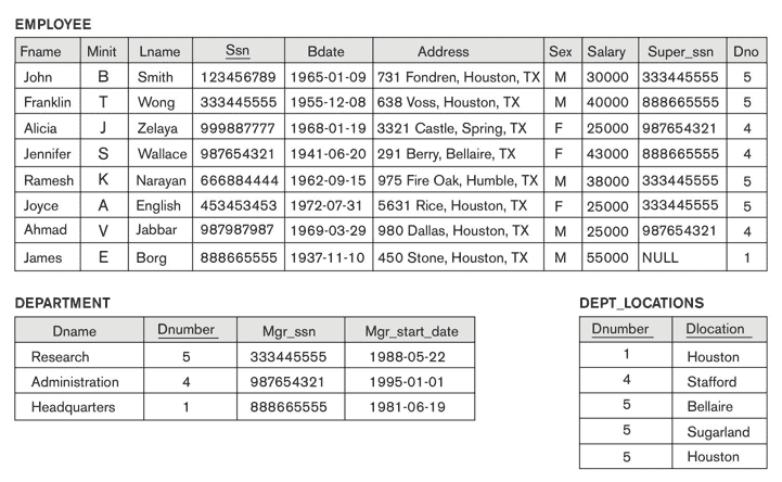

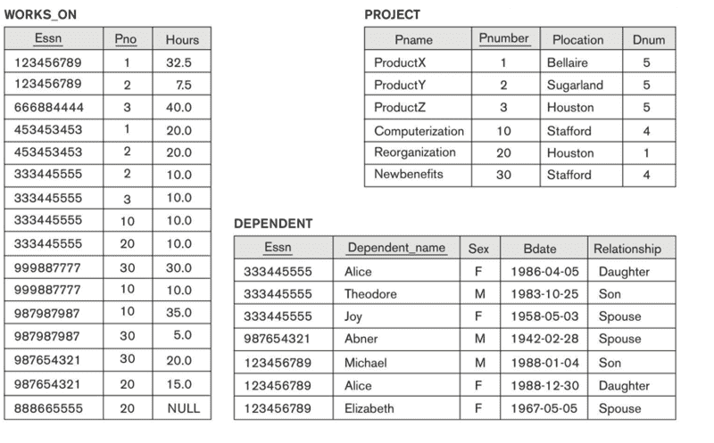

I have 4 tables employee, project,department,works_on.
I have to find all project number that involve an employee with last name='Wong' either as a worker or as a manager of the department that controls the project.
select pnumber
from project,works_on,employee,department
where lname='Wong'
and ((dnum=dnumber and mgr_ssn=ssn) or (essn=ssn and pnumber=pno));

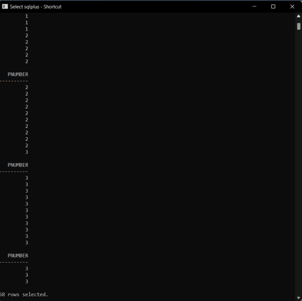

I expect output as 30,20,3,2,1 in a row but I am getting repetitions of these with 20,30 coming 3 times and 3,2 coming 18 times and 1 coming 16 times. I dont understand how combination of condition in where is leading to so many duplicates. Instead of using or if I divide the query into 2 and execute it one by one then I am getting only distinct values. Can you also explain the order by which it traverses through the table and selects tuples and display as to understand why am I getting those multiple values and why in that specific order

Repitition like that is usually due to a cartesian join, where some part of the join is not defined. So each row of one table is joined to EVERY row of another table. And I think that the OR is one of the things doing that. So read up on cartesian joins to see where it is going wrong.
If your select was on more than just Pnumber, say include Pno from works_on, or Pno from works_on and Dnumber from department you should see groupings of data showing how the cartesian join is collecting repetively data on a table by table basis.
It always helps to recover date where you specify the tables in the select's join rather than just a column name. You have not mentioned which table's dnum equals which table's dnumber, for example.

If you join on dnum = dnumber you get nr 5 times 9, since dnumber is 5 thrice and dnum as well. This all goes for the same person, so the join isn't uniquely linked.
Joining with comma's or with the equivalent cross join takes every combination of rows once. If you then specify dnum = dnumber the amount of rows where both equal 5 becomes 9 since for both tables there are 3 such rows. But you also join on pnum = pnumber and these match on 2 and 3 where again dnum = dnumber = 5. Therefore these occurences (2 and 3) are again multiplied by 2, yielding 18 times 2 and 3.
BTW this also occurs on an inner join on the same conditions, you need to take a join condition that uniquely identifies one correct row.
