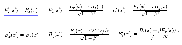

Is that the same as what PAllen has said? If that's the case then:
tade said:
Is there a 4-momentum-esque formula that is exact for classical EM radiation?
If you think I sound churlish or truculent, I can assure you that that's not my intention, though I may sometimes inadvertently come across as so.
No. You can't describe classical EM radiation with a 4-vector. You need an antisymmetric 2-index tensor.
PAllen mentioned "classical massless particle".
Does this mean that the further we are from the Doppler source, the more the EM radiation behaves like classical massless particles, and the closer the 2-index tensor approximates the 4-vector?
