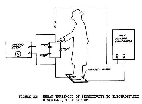

An Investigation of Human Body Electrostatic Discharge
Nov 1993
In an ESD event, the human body can reportedly generate static charge levels as high as 15,000 volts by simply walking across a carpeted floor and 5,000 volts by walking across a linoleum floor.

That's a very good question. The amount of charge involves is so tiny that any regular voltmeter with a finite input impedance, would drain away the charge as soon as it is connected. I don't know the answer.
rollingstein said:
e.g. Walking on a carpet on a dry day charges you to how many volts? Is there a back-of-the-envelope way to estimate that?
here's a test report(random search find) for carpet, looks like a few KV for that sample
.http://www.google.com/url?sa=t&rct=j&q=&esrc=s&source=web&cd=3&cad=rja&uact=8&ved=0CCwQFjAC&url=http://www.patcraft.com/infopacket/test/I0299&ei=9AQxVaCJPIHvoAS_wYBY&usg=AFQjCNGQKyJJmxHcRkkuuHxHqhre_hJUhw&bvm=bv.91071109,d.b2w
they use an :Electrostatic Voltmeter", basically a capacitive device.

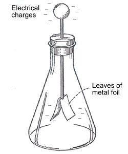

You could build an "electroscope".
According to wiki, it was the first electrical measuring device.
I've never made one myself.
I still haven't put together my Wimshurst machine, so I've no need for one.
Aren't those qualitative? Can they tell if I've been charged to 500 V or 25,000 V by static?
Everything is qualitative, until you start measuring things.
The following site lists some relevant physics equations, and different types of electroscopes.
I would read and dissect it for you, but I'm short of time today.
Electrostatics at Home
Work on your kitchen table with the forces that hold matter together
