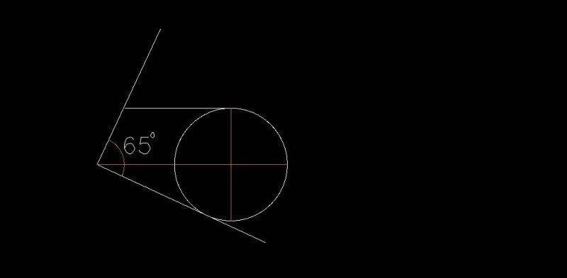

The cylinder in the drawing weighs 100[N]. there is a horizontal rope at the top that prevents it from rolling. what is the coefficient of friction if it's on the verge of movement
Friction force: f=μN
The whole weight of the cylinder lies on the contact point. the coefficient of friction is the tangent of the slope, which is here 250, thus μ=tan 250=0.422
It should be 0.22
  • Diagram of a circle inscribed between two straight lines meeting at a point, with a horizontal line from the top of the circle, and the angle at the vertex labelled 65°.
Have you drawn a free body diagram? The normal component of the contact force is not pointing in the vertical direction. So the normal force is not equal to mg. You need to write down the force balance equations for equilibrium, and you probably also need to write down a moment balance equation. Call N the normal contact force, and call F the tangential contact force.

yes i did that but was is a hurry so i used the other method of the tangent which gave the same result.
$$N=100\cdot \sin 65^0,\ F=100\cdot \cos 65^0$$
$$F=\mu N\rightarrow \mu=\frac{100\cdot \cos 65^0}{100\cdot \sin 65^0}=0.466$$

Shouldn't the tension in the rope contribute to these two equations?
You left out the effect of the rope tension T. That has a component in the normal direction and a component in the tangential direction. The reason that this happened is that you did not draw a free body diagram.

I thought about it but decided that the rope doesn't influence. the rope only balances the moment (torque) and it comes out right according to the book:
$$100\cdot R\cdot\sin 25^0=T\cdot R(1+\cos 25^0)\rightarrow T=22.17$$
I will draw a free body diagram soon

T influences the values of both F and N. Did you really feel that you had advanced beyond the point where you need to draw free body diagrams?
