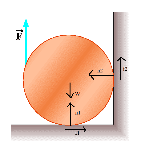

Figure P8.74 shows a vertical force applied tangentially to a uniform cylinder of weight w. The coefficient of static friction between the cylinder and all surfaces is 0.500. Find, in terms of w, the maximum force F that can be applied without causing the cylinder to rotate. [Hint: When the cylinder is on the verge of slipping, both friction forces are at their maximum values. Why?]
Torque = F * d
F = Mg
Friction = coefficient * normal force
There are a few force: weight force, F, <right wall>: normal force to the left, friction force, <lower wall>: friction force to the right, normal force upward. However, I don't know how to combine these forces to solve the problem.

@chet, Yes, I have drawn free body diagrams, but I cannot upload here. The forces on the FBD were written in the "attempt at a solution" section.
From the FBD, I have n1 = coefficient * n2, coefficient * n1 + F + n2 = w. Is that correct?

Yes. Sorry. I didn't read your post carefully enough.
You have 2 equations here and 3 unknowns. The third equation would be a moment balance.

It's ## Fr \sin \theta ##, but I'm still not sure how to apply it. Can you give a start?
OK. Make a list of the moments of each of your forces around the axis of the cylinder. Let's see what you get.
Chet
Torque caused by f1: ## f_1 \cdot R##
Torque caused by n1, W, n2: 0
Torque caused by f2: ##f_2 \cdot R##
Torque caused by F: ##F \cdot -R##
Therefore, ##F = f_1 + f_2##?
Now we have that equation and ## n_1 + f_2 +F= W## and ##f_1 = n_2##?

That all looks right.
