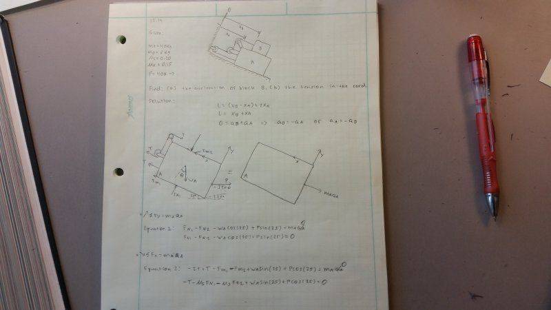

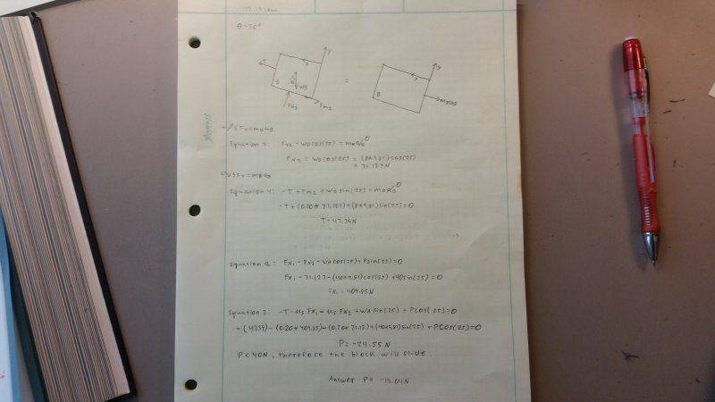

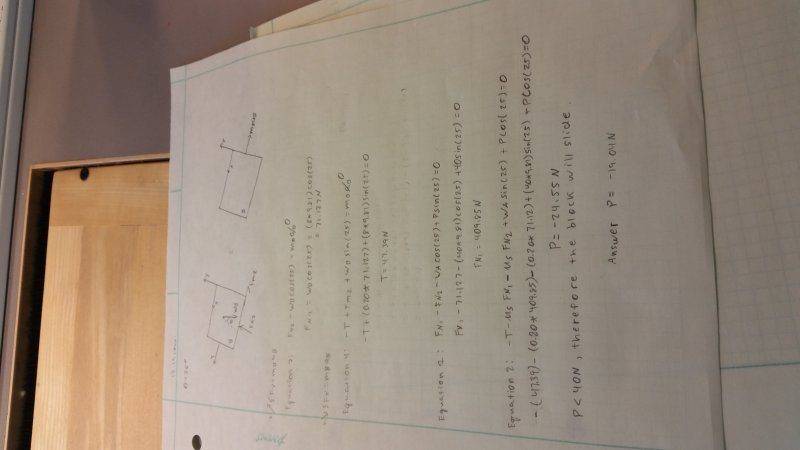

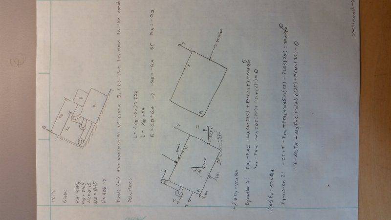

I feel like I've spent way too much time on this problem... So the given information is on the image along with all my work. I am finding the acceleration of the block and the tension in the cable. I know R is going to be the same in all the cords because the pulleys are mass less and we are neglecting friction the pulleys. I first analyzed which way the forces of friction was were applied at each box then I sum of forces in x and y for both blocks but I need to first see if the block is moving. By doing so I used the coefficient of static friction and summed the forces to zero.
So when I solved for P to determine if the block is moving I got -24.55N which is less than 40N, therefore the block is sliding because P <40N.
But the answer to P is -19.04N all my equation are riGht. I verified with the solution key and they match exactly the same but I can't get -19.04N

Images are sideways and all but unreadable -- not enough definition/resolution.
Why don't you draw up a larger image and describe the problem and your work in text, in the post (as the forum rules require!)?

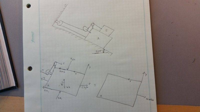

Well I manage to figure out part A and part B of the question... Still let's discuss why my P force is wrong. Let me retake a few pics.
Better?

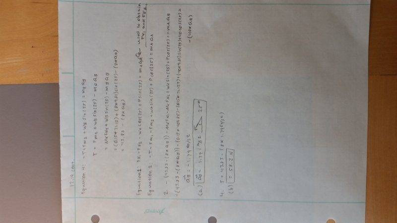

Let me try to rotate the images...
How's that?

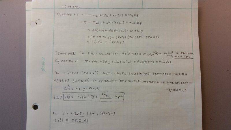

Starting with block A
Sum of the forces in x direction, right being plus (+)
Equation 1: -T-mu_s*FN1-MU_s*FN2+W_A*sin (25)+Pcos (25)=0
Zero because the block is static.
Sum of the forces in y direction, up being plus (+)
Equation 2: FN1-FN2-W_A*cos (25)+P*cos (25)=0 Now looking at block B

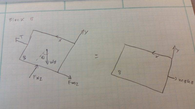

Equation 3: FN2-W_B*cos (25)=0
Zero because we are trying to determine if the blocks will slide.
Equation 4: -T+Fm2+W_b*sin (25)=0
We can now solve for FN2 and T
So once I solve for T and FN2 I use equation 1 and 2 to solve for P

Your free body diagrams look good but what exactly is P now? This is some unknown minimum horizontal force required to hold the whole thing in equilibrium?
