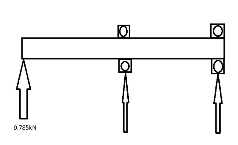

I'm in the process of calculating an axle diameter by using the bending moments which are created with the applied force on the end.
In order to design my axle to be efficient, I believe I need to use the following equation.
Sx = M/Fy
Sx being Plastic Modulus
Fy being Tensile strength of my chosen material
M being the worst case bending moment calculated
I have been told that once I've calculated my Sx, I need to look in the "steel tables" to find the correct diameter of steel tube to use for my axle, however I'm struggling to find access to these tables.
Can anyone point me in the right direction?

First thing to do is define the problem .
Post a drawing showing the axle , related components , basic dimensions and the location and magnitude of the applied loads .

Hopefully the above diagram helps. I have calculated my reactions as 1.099kN on the left bearing and -0.0314kN on the right bearing. Giving me a bending moment of 0.063.
This over the tensile strength of steel (274 mPa) is 0.00023.
So I believe this to be my plastic modulas? (Sx) and I am looking for the right table to find a most suited axle diameter? I am aware this is a very low number I have come out with however I can justify an increase in this with a factor or safety being applied.
What are the distances from the load point to the centre bearing and from the centre bearing to the right hand bearing ?
0.08m to first bearing, 0.2m to second bearing from first bearing

You could do the full bending moment calculation but if you are using a constant diameter axle then you only really need to find the maximum value .
Can you see where this will occur and what it's magnitude will be ?

@ Wilson : Perhaps if we apply some rudimentary engineering knowledge to this problem we might get somewhere .
Is it correct that there is no significant end load on the axle and that rotational speeds are low ?
What are the practical limits of diameter for the axle ?
Are there any stock bar sizes that would be convenient to use if they could be shown to be adequately strong ?
Does the axle have to fit bore of any particular bearings ?

1. Only the load shown in the previous diagram and this axle will be manually driven at low speeds.
2. Between 10mm and 23mm.
3. Preferably a stock bar sized would be used for the axle to keep costs down, so the closest one to the needed axle.
4. I am yet to select my bearings but only plan on using standard ball bearings so bore diameter should be able to vary as needed.
Hope this helps.
Lets see where we go with 20 mm .
With your calculated value of bending moment what would be the maximum stress level in an axle made from this diameter bar ?

By maximum stress level is that the bending stress? which is My/I
m= moment
y= radius
I = moment of intertia
That's it .
nb: The ' I ' should properly be called the Second Moment of Area rather than the Moment of Inertia .

Second moment of area being calculated by pi/4 * r^4 ?
By doing this I get 0.063 * 0.01 / 7.85398 x10-9 = 80214 as the bending stress?
Yes .

Thanks, I will do. Now that I have this bending stress for a 20mm diameter shaft, how do I decide if this is suitable for my application?
Or do we now look at torsional stress?
What units ?
0.063kNm * 0.01m / 7.85398 x10-9m4
0.00063kNm2 / 7.85398 x10-9m4
80214kNm-2 (Not too sure on these units, what should they be?)
Well I think that is 80 MPa which is correct .
Now we need to workout the deflection at the free end of the axle where the 785 N load is applied .
Can you do that ?
