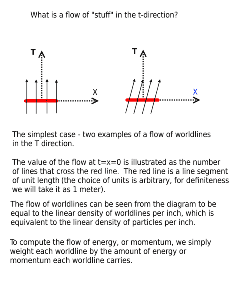

I'm trying to build off definitions like the following.
http://web.mit.edu/edbert/GR/gr2b.pdf said:
The stress-energy tensor is symmetric and defined so that ##T^{uv}## is the flux of momentem ##p^{u}## across a surface of constant ##x^{v}##
Baez has a similar approach. Schutz is referened, I don't have that textbook alas.
In the case of a gas , or a swarm of particles, for the 1space + 1 time case, this can be illustrated neatly by a space-time diagram of the particles, as per the attachment. The particles are assumed to not interact at all (no fields).
I wanted to make the definition more general though. I was hoping to say a few words about how the idea generalized from the simplistic "swarm of particles" to the more general cases, such as fields. I don't see anyway to do this at the moment, however.
I was thinking of making a small FAQ on the topic, we get enough quesitons about it.
The attached diagram should give some insight into the approach I'm taking. There are a few more diagrams, another for "flow in the x direction", and some illustrations of how you can compute the flow in an arbitrary direction (say the t' direction of a boosted observer) knowing the flow in the t and x directions.
Two space-time diagrams with T and X axes showing worldlines crossing a red line segment; the left has vertical worldlines, the right has tilted worldlines, with a caption on the flow of stuff in the t-direction.
  • Two space-time diagrams with axes T (up) and X (right); a red unit segment on the X axis is crossed by vertical worldlines in the left diagram and slanted worldlines in the right diagram.
If the velocities in a Lagrangian are replaced by the gradients ##\frac{\partial \phi}{\partial x^\mu}##of a field ##\phi## it's easier to see the connection between the field Lagrangian and the SET than it is with the mechanical description. See Itzykson&Zuber, page 22.

No, I don't because I can derive it (not just define it) within the canonical formalism. This is
exactly the reason why Hilbert definition of SET is annoying: There is no room in the
canonical formalism which allows you to derive the expression
[tex]\frac{ \delta S_{ m } }{ \delta g^{ \mu \nu } } = \frac{ 1 }{ 2 } \sqrt{ - g } \ T_{ \mu \nu }.[/tex]
If you know how to derive it, I would love to see how.
