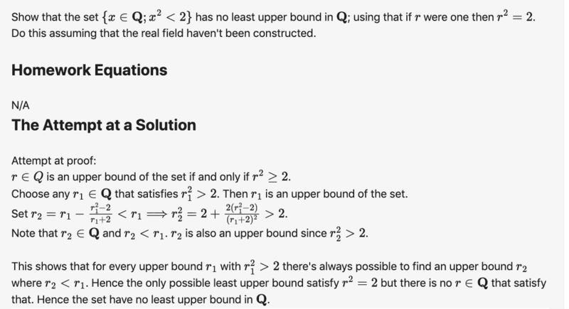

If you understand this, you should do the second half of the proof for the case where ##s^2 > 2##.
is 2s/n+1/n^2 in S tho?PeroK said:That's the contradiction. And it all started by assuming that ##s = \sup(S)##.
##s## is rational and ##n## is a natural number, so yes, that is definitely a rational number.lys04 said:is 2s/n+1/n^2 in S tho?
Ok so you’re supposing s is the supremum of S, which when squared should be a number that is extremely close to 2, but not exactly since there is no sqrt 2 in Q.PeroK said:##s## is rational and ##n## is a natural number, so yes, that is definitely a rational number.
That question makes no sense.lys04 said:Ok so you’re supposing s is the supremum of S, which when squared should be a number that is extremely close to 2, but not exactly since there is no sqrt 2 in Q.
And since s is the supremum, there should be no number whose squared is bigger than it?
But how is 2s/n+1/n^2 in S?
That number is arbitrarily small for increasing ##n##.lys04 said:Even though it’s a rational number. (2s/n+1/n^2)^2=4s^2/n^2+4s/n^3+1/n^4. How is this less than 2?

Hello, found this proof online, I was wondering why they defined r_2=r_1-(r_1^2-2)/(r_1+2)? i understand the numerator, because if i did r_1^2-4 then there might be a chance that this becomes negative. But for the denominator, instead of plus 2, can i do plus 10 as well? or some other number thats positive
