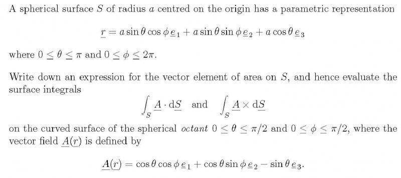

Hi,
Ok, so for the first part of this question it asks to evaluate the integral of the dot product between A and dS. The magnitude of dS is as shown above, and it is in the radial direction in spherical polar coordinates. Here, A(r) is the unit vector of θ in spherical polar. And since we know that the polar direction θ and the radial direction are orthogonal to each, their dot product must = 0. Therefore, the integral of A.dS must be equal to zero. Is this line of thought correct?
Thanks.
  • Typeset problem statement: a spherical surface S of radius a with parametric form r = a sin θ cos φ e1 + a sin θ sin φ e2 + a cos θ e3, 0 ≤ θ ≤ π, 0 ≤ φ ≤ 2π; asks for the area element and surface integrals of A·dS and A×dS over the octant, with A = cos θ cos φ e1 + cos θ sin φ e2 − sin θ e3.

Hi,
Thanks.
No, the direction of [itex]d\underline{S}[/itex] is not "in the radial direction". The "vector differential of area" is [itex](a^2cos(\theta)sin^2(\phi)\vec{i}+ a^2sin(\theta)sin^2(\phi)\vec{j}+ a^2 sin(\phi)cos(\phi)\vec{k})d\theta d\phi[/itex]. That is not a multiple of a radial vector which would be of the form [itex]r cos(\theta)sin(\phi)\vec{i}+ r sin(\theta)sin(\phi)\vec{j}+ r cos(\phi)\vec{k}[/itex].

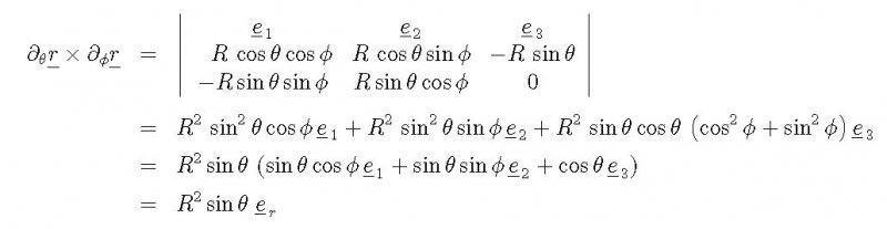

Thanks for the reply. But if I'm thinking about this right, couldn't you factor out of that vector the scalar a^2*sin(α) which would leave the unit vector in the radial direction? Please see the attached.
  • Handwritten cross product derivation in spherical coordinates: the determinant of unit vectors e1, e2, e3 with R cos θ cos φ, R cos θ sin φ, -R sin θ and related entries, simplifying to R² sin θ e_r.
