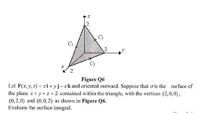

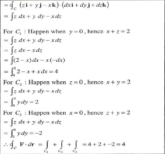

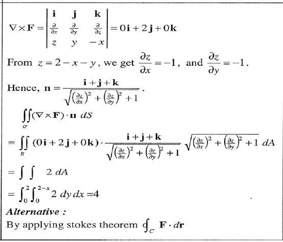

Is the solution provided by the author wrong ? Stokes theorem is used to calculate the line integral of vector filed , am i right ?
To find the surface integral of many different planes in a solid , we need to use Gauss theorem , right ?

The author doesn't seem to specify what surface integral he is asking for. If he wants ## \int F \cdot dA ##, Gauss' law works for the surface enclosing a volume, and wouldn't apply here. If he wants you to evaluate ## \int \nabla \times F \cdot \, dA ##, you can use Stokes theorem and alternatively compute the line integral of ## \oint F \cdot \, ds ## around the perimeter. ## \\ ## editing... If the author wants you to evaluate ## \int F \cdot \, dA ##, there are no shortcuts that I know of=neither Gauss' law or Stokes theorem will apply. You simply need to crank it out the long way... And none of us are infallible=it is my guess the author made a mistake.
Likes fonseh
Do you mean that the author maybe mean find the line integral and not find surface integral in this question ?
Frequently in such problems the author wants you to demonstrate Stokes' theorem by working it both ways. It's a learning thing.
