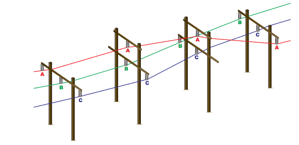

http://i.imgur.com/YbSVvRW.gif
Here is a dramatic way to get unbalanced phases.

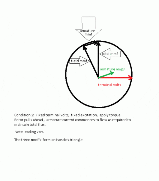

y.php?image=http%3A%2F%2Fi232.photobucket.com%2Falbums%2Fee289%2Foldjimh%2Fugenetic2_zpsb383c1b1.gif
This simple little diagram has helped me more than once:smile:. Your way of explaining things is really amazing!
Just a couple of questions..
When steam supply to the turbine is increased, mechanical torque on the rotor is also increased, which makes it advance in angular position and take up the load. But what makes it rotate at a constant speed after providing extra torque? Is it the "motor action" of injected reactive current that creates an opposing torque?
Also, when the grid injects reactive current into the machine, total flux remains constant and hence, terminal voltage remains constant. Then when exactly are AVRs used? The voltage is kept constant by the grid itself. I know AVRs change field excitation and changing the excitation changes the power factor but since the voltage is held constant by the grid itself(by injecting reactive currents), how are AVRs used practically?
Motor action is exact right term but the current that produces torque is the real component not the reactive...
Note in that phasor sketch above armature and field fluxes are nearly perpendicular so torque results. Were they aligned, they simply aid or oppose instead of making torque.

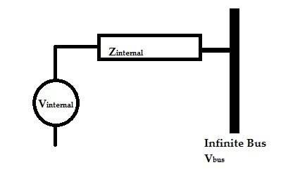

In simplest terms, a utility generator is like any other voltage source it has internal impedance. In fact, quite a bit of it and it's mostly inductive.
Think of the generator as a Thevenin, an internal ideal voltage source in series with that internal impedance.
The AVR measures terminal volts and adjusts the internal source so as to cancel the drop across that internal impedance.
That keeps customers' voltage nearly constant.
Hmmmm i sort of think the other way
the grid is held constant by the combined actions of the hundreds of AVR's working to that end.
Were a generator actually tied directly to an infinite bus you're right, it could not change terminal volts.
Go back to the thevenin idea for a moment
Vbus is fixed, so is Zinternal
If you change Vinternal by changing excitation,
machine amps will change by ΔVinternal / Zinternal
and Zinternal being (mostly) inductive and fixed, Δmachine amps will be reactive. That's why voltage regulator controls Vars. AVR's keep each machine's Var contribution constant, too
All the AVR's acting in concert is what keeps Vbus nearly constant.and the system stable.
