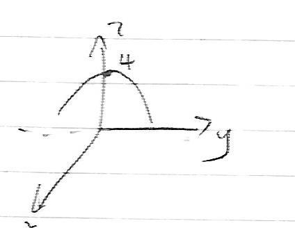

Is my diagram correct ?
I'm wondering , why shouldn't we move the entire graph 'forward ' to x = 2 ? [/B]

Your diagram is o.k. so far. Except you are right that it should be at ##x=2##.
Which thoughts brought you to draw it this way. i.e. which equation did you use?
Next you have to find out, how to calculate a slope at a point. Do you know what this means?

by looking at the the equation z = 4-(y^2) alone , the whole graph is at x=0 axis alone , right ?
No, it should be at ##x=2## as you've said earlier. But that doesn't change the question, because you have eliminated ##x## in the equation anyway. So you have only a curve in a plane, the same as the usual ##(x,y)## case. The variables simply have different names and all is ##(y,z)## instead. And the slope of a tangent at the curve in a point ##(2,1,3)## is now simply at ##y=1## and ##z=z(y)=4-y^2##.
You are correct, except you didn't say how to calculate this slope.

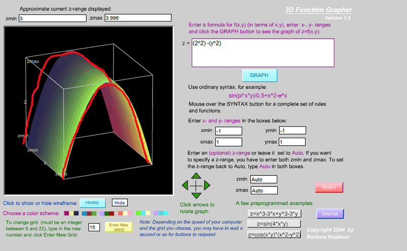

do you mean for z= (x^2) - (y^2) , when x =2 , z= 4 - (y^2) , we draw the curve at x = 0 first , then , extend the line along x-axis and draw another same curve at x = 2?
I mean we draw it at ##x=2## in the first place. The question asks about the point ##(2,1,3)## and this point isn't part of anything with ##x=0##.
Also at ##x=0## the parabola becomes ##z=-y^2## which is shifted by ##4## compared to ##z=4-y^2##.
In your computer graphic you set ##x=2## as a constant dimension of a 3D space which it is not. A point ##(0,1,-1)## is on the original surface, however, not on the surface of your computer graphic. Have a look how it really looks like:
