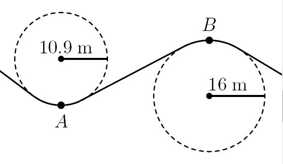

A roller-coaster car speeds down a hill past point A and then rolls up a hill past point B, as shown in the above figure.
What is the maximum speed the car can have at point B for the gravitational force to hold it on the track?
Here the force of gravity is the centripetal force...but...would you include normal force? And how would you go about solving it?

This is shockingly bad. As D H said above, your instructor is mixing up centripetal and centrifugal force. No excuse.
(1) The car is most certainly accelerating at point B--it's moving along the arc of a circle and thus is centripetally accelerated (towards the center of the circle).
(2) The forces acting on the car are gravity and the normal force. To find the point where the car is just about to lose contact with the road, set the normal force to zero.
(3) Apply Newton's 2nd law:
ΣF = ma
mg = mac = mv2/r

Wrong! The velocity is zero, not the acceleration. Just because velocity is zero at some point in time does not mean the acceleration (and hence the net force) is zero. Your instructor happened to get the right answer here. He or she got lucky.
So what's the right way to solve this problem?
Looking at this problem kinematically, the car is moving along a circular path. For both uniform and non-uniform circular motion, the radial component of velocity is identically zero but the radial component of acceleration is v(t)^2/r, directed inward. (The tangential component of velocity is non-zero in non-uniform circular motion, but that is irrelevant here.) At the top of the arc, the car must be accelerating downward with an acceleration of v_t^2/r if it is to follow the arc.
Looking at the problem dynamically, the forces acting on the car are gravity, the normal force, and frictional forces. At the top of the arc, gravity is downward, normal to the arc, and the normal force is upward. Those frictional forces are irrelevant to this problem. All we care about is the radial component of acceleration.
Equating the kinematic and dynamic points of view let's us solve for the normal force \vec F_N. Denoting "up" as being positive,
\aligned<br /> \vec F_{net,vertical} &amp;= \vec F_g + \vec F_n = -mg + \vec F_N &amp; \text{(dynamics)}\\<br /> \vec F_{net,vertical} &amp;= -m\frac {v_t^2}{r} &amp; \text{(kinematics)} \\<br /> \vec F_N &amp;= m\left(g-\frac {v_t^2}{r}\right) &amp; \text{solving for\ } \vec F_N<br /> \endaligned
The normal force must be non-negative. A negative normal force would mean the car's wheels are in some sealed track that keeps the car from flying off. That is not the case here. Thus the condition for the car to stay on the track is
v_t \le \sqrt{gr}
The car will leave the track when the tangential velocity exceeds this limit.
