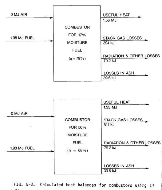

So I've been trying to start a fire in which was successful for 10 minutes then died down due to high moisture in the leaves and branches. Which made me think of this phenomenon.
is there a graph relationship to burning an organic, non-metal material that is well defined in relation to the moisture amount? And are there better terms to describe this? I imagine the water content in wood is too general and the temperature would vary with different woods.
However, is there documented data on what temperature would be needed to burn carbon and water mixture?
I'm thinking of the x-axis having the temperature and on the y-axis a ratio of carbon to water starting at 100:0 and ending to 0:100 in which there are 100 moles of carbon to zero moles of water and ending in 0 moles of carbon to 100 moles of water. This graph could be repeated with other useful common elements or extrapolated out to other compounds to predict what temperature is needed to make wet, soggy wood burn.
x= temperature
y= material:water content
Thank you for your time reading! hope your day is going well :)

Well, wood is a lot more than carbon. You'd have to factor in the materials made using the carbon - mostly cellulose.

The energy released by burning must be sufficient to vaporise all the water that is present in the material. That requires material be steadily fed into an oven to maintain the process.

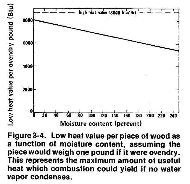

The temperature needed to start wood burning is the same regardless of moisture content. The heat needed to get that temperature depends on the moisture because the water must be driven off before the wood can get hot enough to burn.

The following, from Wood Combustion Principles, Processes, and Economics, by Tillman, Rossi, and Kitto, shows a theoretical calculation for the amount of heat available from wood at different moisture contents.
This book is from 1981. It is written for technical people that want to know the math and chemistry of wood combustion. There may be newer and/or better books on the subject today.
Another excellent resource, from 1976, is The Woodburners Encyclopedia. This book is for people that want less math and chemistry. It is out of print, but used copies are available. This figure is from The Woodburners Encyclopedia:
