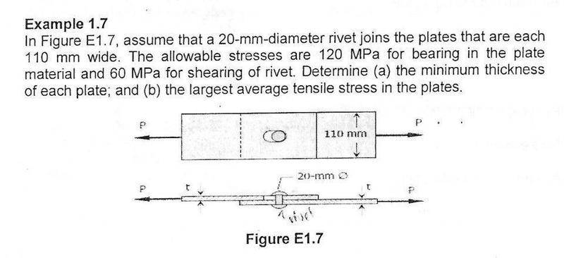

can someone explain about part b (tensile stress) here? in which way does the stress act?
FromW wikipedia, tensile stress refres to the stress to break a rope...How does it related to the case above?

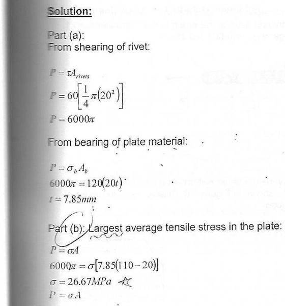

i don't understand the area 7.85(110-20), can you explain about it?

You have to start at part a) of the problem. That's where the thickness of the plates is established (t = 7.85 mm)
The plate is 110 mm wide and has a 20-mm diameter rivet punched through the middle. What's the net width of material where the rivet is located?
These are fairly simple problems to figure out from the diagrams given. If you have this much difficulty now, it's not going to look good on any exams you'll have to take.
It's because the formula for area here is (d)(t) where d is diameter and t is thickness thus (110-20) for the remaining area and t is (20)

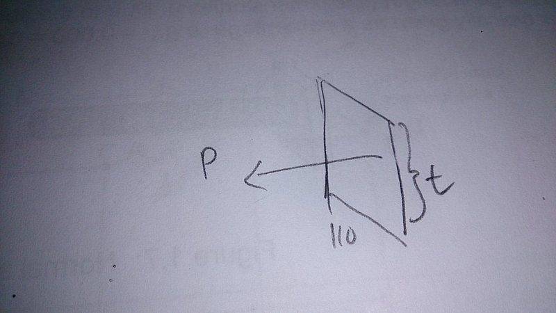

i mean this. Force P is acting perpendicularly to cross section area = t(110-20), is it correct?
Yes, that appears to be correct.
