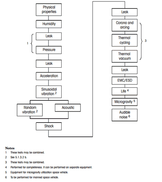

Hi y'alllll!
Need some guidance on a little issue,
As you very well know, european standards (ecss) exist for space systems but they are generally outlined for launch vehicles. Do specific standards exist for payload fairings? For example a test sequence is outlined for general space vehicles in (ecss e-10-03A) which is :
photos upload
Does a test sequence such as this exist for payload fairings?
Given that fairings failures have caused a number of satellite launch losses, I'm certain that such a sequence exists.
