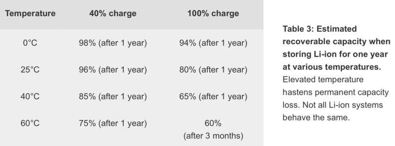

  • Things with a battery will see a degraded battery capacity over time, mainly coming from the number of charge cycles. Lowering power consumption will make the battery last longer.

There is a separate but closely related issue for laptop computers that should be mentioned.
When your laptop is shut down, the battery charging circuit is still active. Spontaneous fire in lithium ion batteries is a risk and heightened while charging. The risk is not just computer failure, but also a structure fire. For that reason, the recommendation for laptops is to remove the battery if you leave it plugged in all the time. The laptop will still function normally when plugged in without the battery (but it will stop on a momentary power failure).
Some office laptops are used as desktops, always plugged in and never intended to use as a portable device. Especially in those cases, the battery should be removed.
I confess that I don't follow that advice myself, but I do acknowledge the risk-convenience trade-off.

Pleonasm said:
https://www.cnet.com/news/apple-genius-turn-off-your-phone-for-better-battery-life/
Why would battery longevity imrpove from nightly shutdowns? I lose 2% from just starting it up,... about the same that procentage lost over night if the phone is on airplane mode.
https://batteryuniversity.com/learn/article/how_to_prolong_lithium_based_batteries said:
Lithium-ion suffers from stress when exposed to heat, so does keeping a cell at a high charge voltage. A battery dwelling above 30°C (86°F) is considered elevated temperature and for most Li-ion a voltage above 4.10V/cell is deemed as high voltage. Exposing the battery to high temperature and dwelling in a full state-of-charge for an extended time can be more stressful than cycling. Table 3 demonstrates capacity loss as a function of temperature and SoC.
Likes elusiveshame, russ_watters and Klystron
  • #38
anorlunda said:
I searched for a study comparing PCs which stay on always with those that power off every night. I couldn't find one. If there was such a study, it could provide the definitive answer.
There are now publicity campaigns trying to convince people to stop wasting electricity (and being more green) by powering down all devices that draw standby power overnight. That is more than PCs, entertainment center boxes are a major culprit. There are also EU and US regulations mandating reduced standby power consumption.
The situation today is much better than in 2000, yet we still see public estimates such as below. I am skeptical of that 10% number, but I have no hard data. Nevertheless, it is foreseeable that some lawmaker will one day forbid leaving personal computers on 24x7, and perhaps forbidding standby mode for all consumer devices.
I don't have the time to find it, but I think Google or someone had some interesting data.
My understanding of the question is more do you let it run 24/7 or shut down at night, google or facebook, one of them, used domestic computers for their server farms so had interesting data on MTBF for things like spinning drives, and I think the standard theory was less power cycles = more run time, but based on the statistical data they measured (from 1000's of PC's and their component failure rates) they didn't notice any effect (between power off at night and run 24/7).
Re original question re shut down vs hibernate, I doubt there is a lot of difference, both are basically "off", but if looking at keep running 24/7 vs some low power state (hybernate/shutdown/sleep) the thought was the life saved due to the "off" period would be less than the wear a power cycle/thermal cycle added, therefore its better to not turn it off.
Even though the data says there was not statistical diff between off at each night and run 24/7, I just feel better if my spin drives are running at a constant temp constant speed.
Note that from a greeny perspective, we heat the house at least half the year so at that point its parasitic heating that reduces the load on the furnace :P
Likes anorlunda and Klystron
