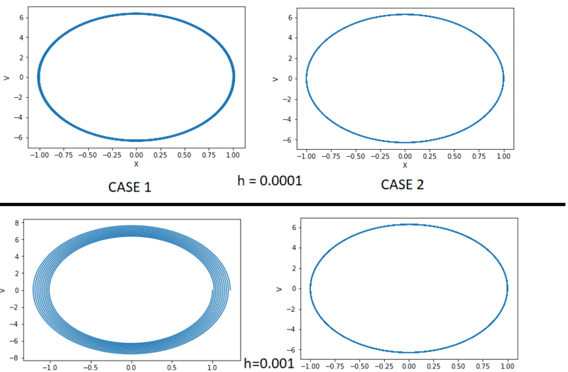

Its coming out to an ellipse of sort, Although in the proper Euler's algorithm, it's coming out to be really smudgy(cos the energy isn't really conserved at the bigger interval) . That's all I understand from this.

View attachment 235975Its coming out to an ellipse of sort, Although in the proper Euler's algorithm, it's coming out to be really smudgy(cos the energy isn't really conserved at the bigger interval) . That's all I understand from this.
These are known as trajectories in phase-space. The energy is related to the position in phase space. The exact solution gives an ellipse.
If you start by the result on the lower left, you will notice that the trajectory is not closed. Instead of coming back to the initial point, after one orbit the position obtained is slightly greater than it was before. The trajectory is spiralling out, and consequently the energy keeps increasing.
The result for case 2 is better, and at the scale of the plot, the trajectory appears to be closed (this might not be exactly true). Nevertheless, the trajectory is not perfect, which leads to an oscillation of the energy. You will notice that the energy oscillates twice during one orbit, corresponding to x = 1 → x = 0 → x = -1 (first oscillation), then x = -1 → x = 0 → x = 1 (second oscillation). By symmetry, it doesn't matter if you are on the bottom part of the orbit or the top part.
An algorithm that conserves energy will preserve the area of the trajectory in phase space, but the shape of the trajectory in phase space can still be deformed (compared to the exact solution).
