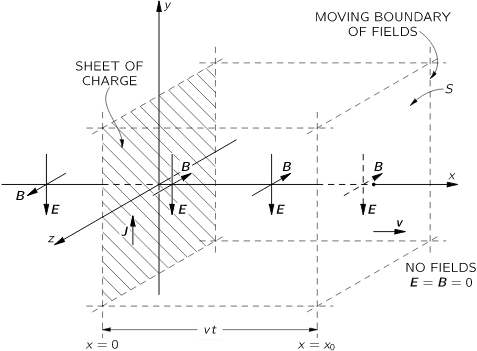

I'm curious if someone help me understand why the electric and magnetic forces are IN PHASE at right angles to one another?
Should they not be 90 degrees out of phase in order to conserve energy? I do understand they are in phase but why?

Just solve the free Maxwell equations with the plane-wave ansatz

This implies that ##\vec{E}## and ##\vec{B}## are always in phase and perpendicular to each other.
In a standing wave the fields are 90 degrees out of phase.
You could write down traveling plane wave guesses for the electric and magnetic fields that were 90 out of phase and if you plug your guess into Maxwell's equations your guess won't satisfy Maxwell's equations? Maybe in the process of doing so you might come to an intuitive understanding why they are in phase in a traveling wave?
Feynman discusses in infinite plane of charge given sudden motion. It might help.
http://www.feynmanlectures.caltech.edu/II_18.html
