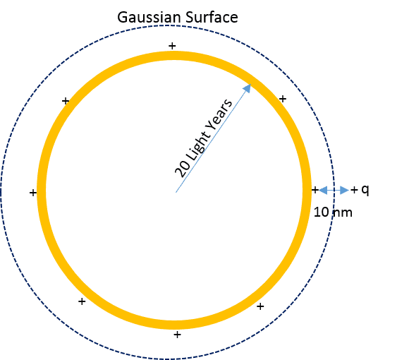

BvU, I think my scenario is quite simple. I will try to make it simpler to emphasize my point and I will start with a picture:
http://[ATTACH=full]200201[/ATTACH]
So what is the Electric field at q? given that the sphere has symmetric charge distripution of ex.14 (I have only drawn in 2D). Is the field 12*q/4πε*R^2 (according to Gauss) or q/4πε*(10nm)^2.

Much clearer ! You have no symmetry under small rotations, so the Gauss result isn't valid.
##\pi\over 8## in the picture, for instance :smile: changes distance to nearest elecron from 10 nm to ##5\pi## light years. That's quite a change ... :rolleyes:

Ok we can take the argument to the other extreme, We can charge the sphere unifromally with 10^48 electrons to have have about 0.4 electrons /nm2, will the E-field at q be (10^48)*q/4πε*R^2 ?. The point is (I think) we can charge the sphere with any number of point charges and most of the time we won't get the right field by Gauss's law.
##4\pi r^2 = 4.5 \times 10^{35} ## m2 for 20 ly, so with ## 10^{48} ## electrons you don't get much more than two electrons per ##\mu m^2##.
Need a factor 1 million more electrons to reduce that to nm2 and by then their separation is such that the field at 10 nm is as good as radial and Gauss flies.
I think I made a mistake in the input of the light year value, thanks for the correction. So, can we say that Gauss's law is limited to the charge distributions which are very dense (relative to the distance to the outside point of field application) so as to have a uniform radial electric field at that point?.
Yes. Note that 10 nm is really very small.
And effective use of gauss requires some symmetry -- so the charge distribution is rather restricted (at least locally uniform, most oftten)
