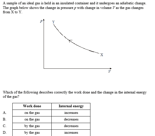

Conceptual qn
work is done in gas but how can internal energy change?
there is no heat flow since it is an adiabatic process[/B]

From the first law, for an adiabatic process, ##\Delta U=-W##, where W is the work done by the gas on the surroundings. In this situation, W is negative (the surroundings do work on the gas), so that ##\Delta U## is positive. The temperature of the gas actually rises, even though no heat was transferred to the gas. This is the same thing that happens when you compress air with a bicycle pump.
