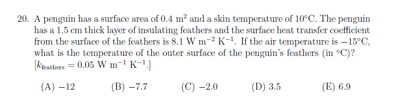

h = k/d
1/h (total) = 1/h + 1/h + 1/h... + 1/h (surf)
Q/t = h A T
For the thermodynamic one i got up to calculating the total heat transfer coeffecient but i don't know where to go from there as its asking for the outside temperature of the feathers, whilst giving an air temperature (-15 degrees).
Help would be greatly appreciated ~ Adam
Could you sketch the thermal "circuit" showing the temperature points and thermal resistance between each? Think ratios or "potential divider" if familiar with electronics.
Hello i tried sketching the circuit but i just can't seem to get it. Is there some sort of 3rd layer between the feathers and air? If so how would i go about finding the temperature of it? Also I am not familiar with potential dividers
Look up "surface heat transfer coefficient". The "third layer" as you called it is the surface of the feathers.
