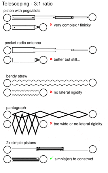

I'd like some help from builders - modellers or mechanical tinkerers.
I'm trying to build the skeletons of some polyhedra - the vertices are intersections of rods - no faces. http://www.reed.edu/~mcphailb/puzzles/images/hex.bmp"
I want to be able to telescope the rods by about 3x. So, I could slide them anywhere between, say, 1" long and 3" inches long at will.
One way to do it is to use a rod-and-sleeve or piston design with brass rod and hollow brass tubing that you can buy at a hobby store. Trouble with this idea is that it won't compress to one third of its length - only half at best. To do a factor of three I'd need one rod surrounded by a sleeve surrounded by another sleeve. see attached diagram
It gets way more complicated when you add in mechanisms to stop the pistons from simply falling apart at full extension - they need slots and pegs, etc.
I'm looking for fresh ideas on how I can get the effect I want with less building and tinkering and with more reliability so that it doesn't fall apart. Less work would be nice too. If I can start with materials that I don't have to completely craft, that'd be great. I have to make 32 of em.
The rods should smoothly expand and contract by a factor of about three, yet remain rigid.
It doesn't have to be overly strong, I've been toying with plastic tubing and elastic bands and stuff.
Ideas?

Regarding telescoping devices, if you must have 3X expansion then you need more than 3 sections since a fraction of each section must remain unextended just to hold the device together. So you would be looking at 4 telescoping sections. Depending on the size and sturdiness you require, you can even make these by rolling paper into tubes of appropriate sizes. It can work well enough if it's just for a model. Just don't sit on it...

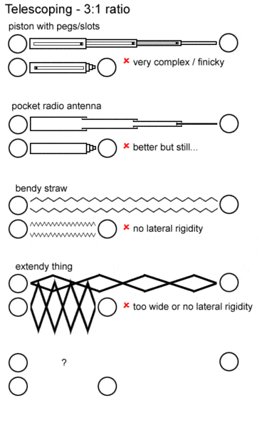

Ideas I've got so far.
  • Sketch comparing telescoping mechanisms for a 3:1 ratio: piston with pegs and slots, pocket radio antenna, bendy straw, and an extendy lattice, each with circles at the ends and a red cross marking its drawbacks.

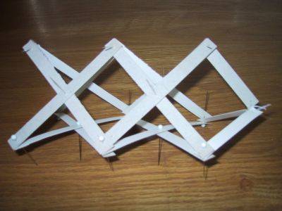

But behold: the 3D pantograph! Expertly manufactured from authentic cardboard pieces professionally fastened using high quality stainless steel pins, the 3D pantograph is exhibited here atop a rich oak surface. This inspiring design will lend elegance to any decor or polyhedron.
Photo of a white cardboard scissor-linkage mechanism, a collapsible pantograph-style frame with pinned crossing arms, resting on a wooden tabletop.
It does run counter to your "less work would be nice" condition though... But it is rigid and it extends easily.

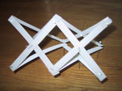

Uhh... Here's one possibility.
Photo of a folding pantograph-style linkage made of white popsicle sticks pinned together at crossing points, lying on a wooden table.
Either connect three edges with a wire, or your vertice balls can connect to three of them separately, or if your pantograph is made up of many segments then you can connect only one of the three ends to the vertex and it still works, although a bit unevenly... You will have to get your popsicle sticks together to work out the details. The end joints have to remain a little loose for example because the angles vary as the pantogram contracts and expands. Rounded ends would help.

Man that's hard to build. I'm trying to construct it from wood skewers and elastics.
Oh, I see why. Yours is simply 3 pantographs attached at their outer vertices. What I was building was 3 pantographs attached at their inner intersections.
OK, I've got an idea I can live with.
No one said I could only use one axis. So I've simplified the piston construction and glued two side by side. See diagram labelled PF070303telescope2.

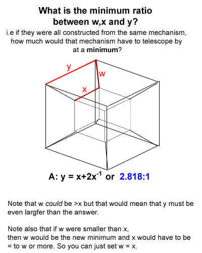

Also, I've calcuated that the max telecope extension does not need to be quite 3x, it needs to be only 1+2(root 2) = 2.818.
Sigh. I can't describe the problem easily without tipping my hand. So see attached diagram. I'm trying to see how long each segment (all of which are constructed identically) must be able to telescope by.
MY solution is 2.818 (or 1 + 2*(2^-1) ).
  • Wireframe cube in perspective with three edges highlighted in red and labelled y, x and w, with the caption: What is the minimum ratio between w, x and y? A: y = x+2x^-1 or 2.818:1

  • Comparison of telescoping mechanisms at a 3:1 ratio: piston with pegs/slots (very complex), pocket radio antenna (better but still complex), bendy straw (no lateral rigidity), pantograph (too wide or no lateral rigidity), and two simple pistons side by side (simpler to construct, marked with a tick).
