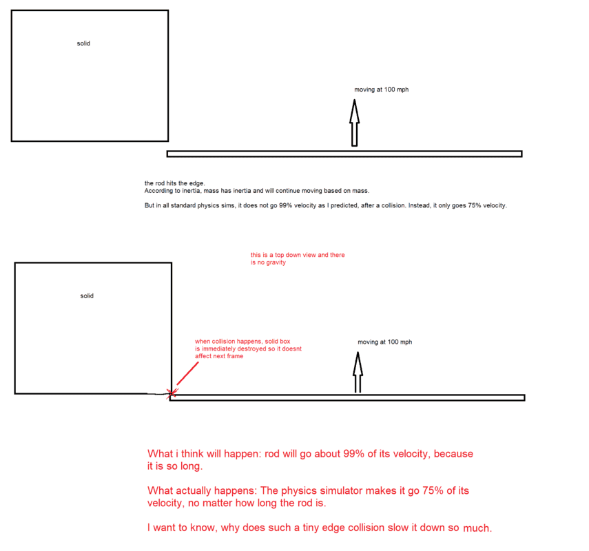

My first thread was closed for being too confusing to read. I will try to make it more clear.
245598
Also some more parameters: Rod and solid has 0 restitution, solid is anchored and does not move, it is instantly deleted upon collision.

As I understand it, you have a hypothetical rigid rod. The left end is brought to rest with a brief impulse. After this event is complete, the object which was the source of that impulse becomes irrelevant and is removed from the simulation.
One might approach this problem by writing down several equations. One equation would involve linear momentum and the unknown impulse. One would involve angular momentum and the unknown impulse. A third would relate the final rotation rate with the final linear velocity based on the known velocity of the left endpoint on the rod.
If the rod is not modeled as being completely rigid then the problem changes. One would need to consider the duration of the impulse and the speed of [transverse] waves in the rod.
Yes.
What I have so far (in my head, the sims used in the OP are not mine) is an equation that applies a force to a point (the angle of force is the normal of the wall collision, though I'm not sure this is actually the correct way to do it.) And it tries different forces until it approaches the correct force that will push the left end of the rod outside of the collision next frame. That is my method, its not very CPU efficient but seems realistic to me. (Actually a more realistic method would probably be first going backwards in time to the first point of contact, then doing something.)
I don't know what method Box2d or algodoo uses, it probably uses calculus or something.

The sims I have tried are Box2d, Algodoo, and a 3rd party one which allows different solvers.

It will depend on the details of the collision. Energy is conserved and none of it goes into the object, so it all stays with the rod. The sum of the rotational and linear kinetic energy after the collision will be equal to the initial kinetic energy before the collision. All the collision is doing is turning some of the linear kinetic energy into rotational kinetic energy; by varying that amount you ill be able to vary the final speed.
Collisions between rigid objects involve infinite forces applied over infinitesimal intervals and infinitesimal displacements. Lots of room for indeterminate results. Lots of room for erroneous reasoning.
Just because both objects are rigid, that does not mean that mechanical energy is conserved. The collision is specified as inelastic. Mechanical energy is not conserved.
However, it is possible to pose an exactly equivalent problem using an elastic collision. Replace the inelastic block with an elastic rubber ball. Tune the mass of the ball so that the rod tip is brought to rest by an elastic collision with the ball.

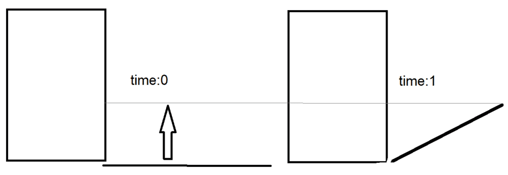

I think what helps me understand the most is when I realize that when one edge is moving forward, the other is moving backward relative to the COM, thus both are actually cancelling each other out. I just thought of this btw.

The original statement of he problem seems unambiguous to me: big block stops the end of stick with no bounce (restitution=0). Block disappears (no more forces on stick)
The unique solution as I described follows immediately and matches simulations.
(The result cannot depend upon mass or length because there is nothing in the problem to set a scale,. The stick is rigid and the wall infinitely massive.)

When the rod strikes the object, the speed of that end of the rod will change. For any given change in speed, there is only one solution and it really is as easy as @hutchphd says to calculate it from there.
The ambiguity that leads to multiple solutions is that it is not completely clear that you intended that the end of the rod would come to a complete stop as opposed to being slowed but continuing to move forward in the instant after the collision.
, but I get the vibe I must make a soft body sim then slowly make it more and more rigid. Seems kinda complicated.
Much much much better is to solve this problem analytically, using what you know about conservation of energy and angular momentum.

Hmm so you are saying to simply, push the contact point downwards vertically until it is outside the solid?

I think the problem is that the rod rotates so at some times its outside of the collision. Also that its an edge with a tip.
I don't understand all the ancillary analysis. Hope this helps!
I am trying to understand what is unclear. The force is applied "percussively" to one end of a finite length stick. Angular momentum about this point of contact is always conserved.
1)If restitution = zero the end of the stick does not rebound and angular momentum conservation alone allows simple solution.
2) If restitution is 1 then additionally energy conservation allows complete solution and characterizes the "bounce" of the stick
In between these extremes it is more complicated...as it is in any collision

Collisions are normally understood to be brief. The tip of the rod is not "pushed" downward. It is "bumped" downward. Once the bump is over, it is over. There is no further force and, often, no further contact.
You have several basic possibilities depending on the exact make-up of the rod and block.
1. The tip of the [rigid] rod bounces off of the [elastic] block. But you do not want this. You want zero restitution. No bounce.
2. The tip of the [rigid] rod stops at the [plastic] block. As if it hit a soft pad and came to rest. No bounce, no restitution. You seem to want this.
3. The tip of the [rigid] rod stops at the [gummy] block and sticks. The rod pivots around the point of attachment. You do not seem to want this.
4. The tip of the [plastic] rod stops at the [rigid] block. But the rest of the rod continues on its way, blissfully unaware that a collision has taken place. The rod flexes more and more and the point of contact is under a continuing force. You want zero restitution. So the rod stays bent.
5. The tip of the [flexible] rod stops at the [rigid] block. The rest of the rod continues on its way, blissfully unaware that a collision has taken place. The rod flexes more and more and the point of contact is under a continuing force. Then it unbends and rebounds. It may or may not continue to vibrate back and forth after the collision is over.
Let us suppose that you choose 2. Let r be the length of the rod.
You have a rigid rod with known velocity and momentum. Multiply the momentum by r/2 you have the the associated angular momentum about the point of contact. The zero restitution assumption means that the rod tip comes to a stop. So you know that the motion immediately following the collision can be [momentarily] seen as a pure rotation about the point of contact. You also know that the interaction involved zero torque about the point of contact.
As @hutchphd points out, conservation of angular momentum allows you to read off the resulting rotation rate (in rad/sec) almost immediately. Divide angular momentum by the moment of inertia of a uniform rod about its endpoint.
Multiply that rotation rate by r/2 and you have the resulting velocity of the center of mass. Done.

Nope. I want it to be rigid. When it is fast, it bounces. But imagine a long heavy rod hitting something slowly. There would be almost no bounce, a nearly 0 restitution.
That is correct, I do not want gummy sticks.
Nope I just want no bounce, but I want a rigid rod.
Nope. No flex, just rigid.
Im not sure how to get the rotation rate. My guess is to get the sum of torques of both ends, but I only know how to apply torques to the center of mass, not an arbitrary point. You said use r/2 but that doesn't seem like it would apply to an arbitrary point, since r is defined as the length of the rod.

Then you want case #2 in spite of your protestations to the contrary.
Maybe a little cushion so it does not bounce at all, but not so much that it is visually apparent.
Right. But no cushion is needed on the rod. The cushion can be on the block.
This problem can in principle be solved by tracking the motion of each atom in the rod and doing the calculation using interatomic forces. If that is your method of choice, give it a go. Might take a while.
If you wish an exact macroscopic answer, intelligent use of momentum conservation will provide it in minutes, as previously and repeatedly described. Your choice.
