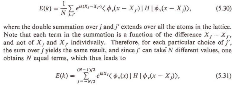

From the textbook of Omar:
Can someone explain me the summation of this? I simply don't get it?
Thanks in advance.
Which summation do you mean?
The second equation is the first one with the argument that the sum over j' looks like "something"+"something"+...+"something" (N times the same summand) = N*"something".
I don't get how you go from the double summation to the new one with the new index etc.
Oh yeah i forgot to say: in the new expression they put Xj' = 0.
It's a function of the difference, Xj-Xj'. For each choice of j',the sum over j yields the same result. => I don't get it.
Also I don't get why you start from -N/2 and end with (N-1)/2
