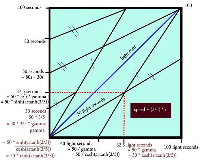

Proper time is a good term. It's traditionally represented by the Greek letter [tex]\tau[/tex] (tau). In special relativity, proper time is a timelike spacetime interval between two events. It's invariant, which means that it's the same in all inertial reference frames. It's equal to the coordinate time in the unique inertial frame of reference where the events happen in the same place as each other. It's unambiguous as long as we define which pair of events we're talking about the proper time between. In Einstein's example, both events lie on the worldline of a certain clock. The first event is the clock showing 0 seconds, and the other event is the clock showing 1 seconds. These events happen in the same place in the clock's rest frame (where, by definitio, the clock is at rest), so the coordinate time in that frame is equal to the proper time between these events. In any other frame, the coordinate time will be greater than the proper time. We find the coordinate time between these events using [tex]t_{coordinate} = \gamma \; \tau[/tex], which is just the time equation from the Lotentz transformation with x = 0.

Yes, time is measured by the number of units, which is why it seemed more natural to me to call time dilation the process whereby a larger number of units is derived from a smaller one.
A "moving" clock runs slow in the sense that it shows less time passing (a smaller number of units) than a "stationary" clock. To an observer who considers themselves stationary, a clock moving relative to this observer will show a smaller number of units as having passed in any given interval than a clock which is stationary relative to the obsever.
The same scenario from a more symmetrical perspective: imagine two clocks, A and B, moving relative to each other at some constant velocity. The proper time between two events on clock A's worldline is always less than the proper time between two events on the worldline of clock B if the following two conditions hold. (1) The first event on clock A's worldline is simultaneous in clock B's rest frame with the first event on clock B's worldline; (2) the second event on clock A's worldline is simultaneous in clock B's rest frame with the second event on clock B's worldline.
Since A and B are arbitrary labels, this will still be true if you swap them.
Events are points in spacetime. In this example, they represent a clock showing a particular time. An object's worldline is its trajectory (the path it takes) through spacetime. In special relativity, which deals with objects moving constant velocity relative to intertial reference frames, worldlines are straight lines.
Another name for the longer of these two intervals of time (the proper time shown by clock B in this example) is the coordinate time in clock B's rest frame of the proper time between the stated pair of events on clock A's worldline.
Best read in with one eye on a spacetime diagram!

I don't understand your first point here. We can conceive of the calculation as making the total bigger, or equivalently as making the units smaller, but not both, because that would be like multiplying by gamma squared, wouldn't it? Or if you made the total of one clock bigger, and the units of the clock you're comparing it to smaller, then that would be like making them both bigger, or both smaller, i.e. multiplying by gamma and dividing by gamma, i.e. no change. But there is a change, the calculation converts 2.2 into 65.
We're talking about the interval of time between two events on the muon's worldline, its creation and its annihilation. This interval is the muon's lifetime. The muon lasts 2.2 microseconds in its own rest frame and 65 microseconds in the rest frame of the lab. The time between events that happen in the same place is the proper time between them (a timelike spacetime interval). Since the muon's birth and death happen in the same place in the muon's rest frame, the proper time between them is 2.2 microseconds. In the lab's rest frame, the coordinate time of this interval is 2.2 * 29.4 = approx. 65 microseconds. If we think of the muon as a clock, we can say informally that the muon is running slow in comparison to a clock at rest in the lab's rest frame in the sense that the muon only counts to 2.2 microseconds while the lab clock counts to 65. From the perspective of an observer at rest with respect to the lab, a 2.2-microsecond muon is slow to disappear; it lasts for 65 seconds.

Hello again, my friend; well here it is:
http://img41.imageshack.us/img41/5448/specialrelativitydiagra.jpg
A Special Relativity diagram to demonstrate the relationship between two Inertial Frames of Reference moving with a constant relative velocity.
A and B represent a single axis (time or length) of Minkowski spacetime for each of the two IFoRs. They are drawn against a common background representing Proper Units
An observer at rest within each IFoR will be experiencing proper units (length and time) within that system; as shewn by the horizontal lines, labelled A and B.
But from each IFoR, the other frame's axis -- rotated according to their relative velocity -- will be reckoned in co-ordinate units, as shewn by the perpendicular projections from the coloured diagonals onto the observer's own axis.
The diagram is drawn to scale to represent two IFoRs with a constant relative velocity = 0.6c, giving [itex]\gamma = 1.25[/itex] and [itex]\frac{1}{\gamma} = 0.8[/itex]
From this we can see exactly what Einstein was saying in http://www.bartleby.com/173/12.html" , when he writes:
But the metre-rod is moving with the velocity v relative to K. It therefore follows that the length of a rigid metre-rod moving in the direction of its length with a velocity v is
of a metre.
For the metre rod moving with the velocity 0.6c relative to B would be represented in the diagram by the number 1 on the red diagonal and we can see the projection onto B's x-axis (as it would be in this scenario) where it would be the green 1 co-ordinate unit.
And this agrees with [tex]{x^'} = \frac {x}{\gamma}[/tex]
i.e. [itex]{x^'} = 0.8x[/itex]
Similarly, in the second part of that same chapter, Einstein writes:
**Let us now consider a seconds-clock which is permanently situated at the origin (x' = 0) of K'. t' = 0 and t' = 1 are two successive ticks of this clock. The first and fourth equations of the Lorentz transformation give for these two ticks:
t = 0
and
As judged from K, the clock is moving with the velocity v; as judged from this reference-body, the time which elapses between two strokes of the clock is not one second, but
seconds, i.e. a somewhat larger time.
And again we can see just how this works, for this time he is converting the time from the observer's frame, [itex]t[/itex] (proper time units) into the observed time [itex]{t^'}[/itex] (co-ordinate time units) which would be to take the blue, 1 proper unit and project it upwards onto the red diagonal line or, indeed, one could read it off the green co-ordinate scale on B's axis.
Not surprisingly this agrees with Einstein's own equation:
[tex]t = \frac{1}{\sqrt{1-\frac{v^2}{c^2}}}[/tex] or
[tex]t = \gamma({t^'}) = 1.25[/tex] co-ordinate units
I am fairly certain that this diagram meets all the conditions, references and relationships between the elements that compose SR as described in this thread.
For instance, the co-ordinate units are greater in number but reduced in size.
The principal problem that is brought to light here is that there are far more elements than at first appear.
Consider if you will:
[itex]1)[/itex] We start with a solitary IFoR where the measurements are all, by definition, in proper units.
[itex]2)[/itex] We add a 2nd IFoR moving at a constant velocity with respect to the first: both are measured in proper units and their times are identical and synchronous.
[itex]3)[/itex] They then observe one another and upon doing so we find that the observed frames are rotated with respect to their observers, as shewn, but their units are still proper units.
[itex]4)[/itex] When observing the rotated frames, their proper units are projected vertically onto the observer's frame of reference, being there-by transformed into co-ordinate units.
[itex]5)[/itex] So we have the axis of each IFoR and its rotation, both measured in Proper units and its projection onto the other's axis measured in co-ordinate units.
[itex]6)[/itex] And as all this is matched reciprocally by the other IFoR we have this duplicated giving 4 measures in proper units and two in co-ordinate units.
Is it any wonder that we become confused when trying to deal with this using only primed and unprimed symbols? :cry:
And this is with it all reduced to two dimensions...:rolleyes:
This exercise has certainly helped me to understand how it all fits together – I only hope that I have understood it correctly? o:)
Many thanks, once again to Rasalhague, and Matheinste whose patience and explanations have been a great help. :rolleyes:

Looks good to me!
The conventional Minkowski spacetime diagram takes a slightly different approach to representing the same information. Here are a couple of examples.
The top diagram in my first attachment, the attachment labelled "parallels", shows which lines are parallel with which. The lower diagram in the same attachment shows the spacetime intervals between the origin and various events (represented by points). As you can see, in this kind of diagram, the intervals aren't exactly represented as the Euclidean distance between points since the hypotenuse of each of those right triangles corresponds to a shorter spacetime interval than the edge that lies along the axis, contrary to what we'd expect from Pythagoras. This is because the equation for the spacetime interval between two events is that of a hyperbola
[tex]||\mathbf{E}_{2} - \mathbf{E}_{1}|| = \sqrt[]{|\Delta t^{2} - \Delta x^{2}|}[/tex]
rather than a circle like the equation that gives the distance between two points in Euclidean space:
[tex]||\mathbf{P}_{2} - \mathbf{P}_{1}|| = \sqrt[]{\Delta y^{2} + \Delta x^{2}}[/tex]
One frame is represented with the vertical time axis and horizontal x axis. The axes of the other frame are inlined towards each other. The faster the frame shown with the inclined axes is traveling relative to the frame shown with orthogonal axes, the closer its axes will be to the dotted line at 45 degrees which represents the path of a photon travelling, of course, at c. The angle [tex]\beta[/tex] represents the speed of either frame relative to the other, as a fraction of the speed of light: v/c.
Any vertical line is the potential worldline of an object at rest in the frame with orthogonal axes; events on those lines happen in the same place in that frame. Any horizontal line is a line of simultaneity in the frame with orthogonal axes; all events on that line will be happen at the same time as each other in that frame.
Similarly, lines parallel to the time axis of the frame with oblique axes represent potential worldlines of objects at rest in the frame with oblique axes; events on those lines happen in the same place in that frame. Lines parallel to the x-axis of the frame with oblique axes are lines of simultaneity in that frame; all events on those lines happen at the same time as each other in that frame.
There's nothing special about either frame. The only difference is that they're moving in opposite directions relative to each other. So we could just as well change our diagram and show the oblique frame with orthogonal axes, and the orthogonal frame with oblique axes. The only difference would be that the axes of our new oblique frame would have a negative slope because its going in the opposite direction to the other frame. So the oblique axes would appear in the 2nd and 4th quadrants, rather than the 1st and 3rd.
My other diagram, the one labelled "hyperbola" is meant to show how this relates to hyperbolic geometry. If we draw a curve through all points on a Minkowski diagram which stand for events with a timelike interval of 1 from the origin, the curve is one branch of a unit hyperbola. Consider one of these events, the one that lies on the axis labelled tau in this diagram. The proper time between the origin and this event is 1. The coordinate time of this interval with respect to the frame represented by the axes labelled here t and x is
[tex]\gamma = \frac{1}{\sqrt[]{1 - \beta^{2}}} = cosh\left(\phi \right)[/tex]
where [tex]\phi[/tex] is the "hyperbolic angle", the input of the hyperbolic trigonometric functions, which corresponds geometrically to the area shaded blue under the hyperbola here. Cosh, sinh and tanh are the hyperbolic cosine, sine and tangent respectively.
[tex]sinh\left(\phi \right) = \gamma \beta[/tex]
and
[tex]tanh\left(\phi \right) = \frac{sinh\left(\phi \right)}{cosh\left(\phi \right)} = \beta[/tex]
so [tex]\phi[/tex] is the value of the inverse hyperbolic tangent of [tex]\beta[/tex]:
[tex]\phi = artanh \left(\beta \right)[/tex]
I gather there are other ways of depicting the Lorentz transformation in two dimensions, but this is the one I'm familiar with, and seems to be the one most commonly used in textbooks. Some more examples here:
http://hubpages.com/author/lgsims96/hot/
So far every source I've looked at has followed this comvention for which way round to depict the time and space axes, with the exception of James Callahan's The Geometryu of Spacetime which has them the other way around:
http://www.google.co.uk/books?id=UM...:+Spacetime+and+Geometry#v=onepage&q=&f=false
