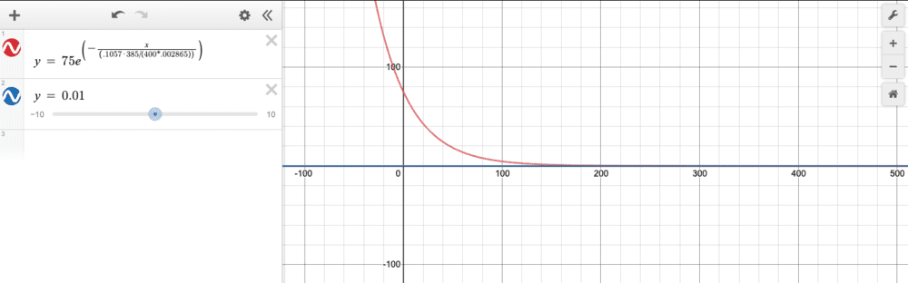

What I am thinking is to use Newtons law of cooling.
where t (time constant) is C/Ah (3.3595)
C = heat capacity (385 J/kgC)
A = heat transfer surface area (28.65 cm^2)
h = heat transfer coefficient (400 W/(m2 K) copper to water)
deltaT(t) = 0.01C
deltaT(0) = 75C
I got 385/(400 * .2865) = 3.3595 for the time constant
solving for t, I got a negative number -74 ish, which does not make sense
deltaT(t) = 0.01C
deltaT(0) = 75C
The time constant should be ##\frac{mC}{Ah}##, not ##\frac{C}{Ah}##. Otherwise, this equation is OK. Also, the area in square meters should be 0.002865, not 0.2865. Also, where did you get that value for the heat transfer coefficient on the water side?
If I do the calculation correctly for the parameters you used, I get a value of about 5 minutes for the heating time. But the heat transfer coefficient you used seems too high to me, at least for getting an upper bound to the heating time. I estimate a value of h about 10x lower than the value you used.

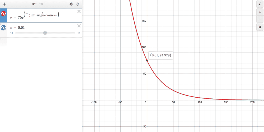

I got the value from https://www.engineeringtoolbox.com/overall-heat-transfer-coefficients-d_284.html
Also, I am still getting a different number now.

The calculation should look like $$\frac{thA}{mC}=\ln{(75/0.01)}=8.92$$
The heat transfer coefficients in that table are typical values for forced convection. As a worst case, we should be looking at values in the limit of no convection. For radial conductive heat transfer in water to a sphere of radius R, the conductive heat transfer coefficient is ##h=k_w/R##, where ##k_w## is the thermal conductivity of water. I used the radius of a copper sphere of the same mass as our cylinder, R = 1.41 cm. This give a value of about h = 40 W/m^2 C.

So it would take around 9 mins to equilibrate?
With a heat transfer coefficient of 400, I get a time constant of 35.5 seconds, and an equilibration time of (35.5)(8.92)= 317 sec = 5.3 minutes. With a heat transfer coefficient of 40, I get a time constant of 355 seconds, and an equilibration time of 53 minutes.
Usually, equilibration is considered to be achieved in practice after 4 time constants (rather than 8.92). With a heat transfer coefficient of 400, that would be 2.4 minutes, and, with a heat transfer coefficient of 40, that would be 23.7 minutes.
