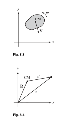

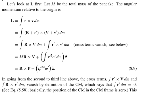

I have read Classical Mechanics book by David Morin, and there are some parts that I do not understand from its derivation.
Note :
## V## and ##v## is respectively the velocity of CM and a particle of the body relative to the fixed origin , while ##v'## is velocity of the particle relative to CM
From this, we can get : $$ v = V + v'$$
In the 3rd step, It is written that ## \int r' \times V\, dm ## vanised because the position of CM in CM frame is zero.
But, isn't the position of CM should be calculated relative to the origin? (Since we are calculating the angular momentum relative to the origin, not CM)
Well, by definition if you are in the CM frame of reference the CM is chosen as the origin of your reference frame. Then also the reference point of the angular momentum is the CM.

Figure 8.4 says it all imho. ##r'## is the position vector in the frame of reference of CM, so when you calculate those terms (the ones that vanish) it is like you are in the frame of reference of CM, regardless if the whole calculation is done in the frame of reference of another point that is taken as origin , different than CM.
so in a nutshell it is
$$\int \vec{r'} dm=\vec{0}$$
$$\int \vec{r} dm=M\vec{R}$$
Ok I might not have explained it very well but here is a better (i think) explanation.
From figure 8.4 it is ##\vec{r'}=\vec{r}-\vec{R}## hence integrating both sides we get $$\int\vec{r'}dm=\int\vec{r}dm-\int\vec{R}dm=M\vec{R}-\vec{R}M=0$$
