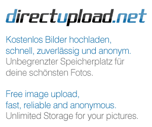

I need transfer function of this circuit (it is Bandaxall tone stack). Here is the sheme:
Any help would be greatly appreciated.

What is the context of your question? If it's for schoolwork, I can move the thread to the Homework Help section of the PF. In any case, you will need to show some effort on your question. How would you go about writing some equations to help you get to the transfer function? Would you use KVL or KCL?
Oh, and the transfer function will also depend on the Zout of the previous stage, and the Zin of the next stage. Do you have those?

I tried to solve it with my basic knowledge of Kirchoff's laws, but I'm not mathematician, I'm an IT student... my task on this project is to simulate this circuit using a C++ library, but to obtain a block scheme I need differential equatins from transfer function.
When I tried to solve it, I ran into 7 equations, of which 4 were current-related (6 unknown currents), and after discussion with my friend I came to conclusion, that I did either something wrong, or the set of those equations cannot be solved (from my point of view - 6 variables, 4 equations), that means I cannot figure out the currents.
The input and output impedances... well I don't have those. (consider it as an ideal circuit?)

No worries, I moved the thread. I only see 5 nodes for writing the KCL equations. Could you please show us the equations you have so far?

First I substituded RA||C2 and RB||C3 for impedaces ZA=RA/(1+s*RA*C2) and ZB=RB/(1+s*RB*C3):
Here I drew the nodes and the currents. And my equations:
KCL:
I1=I2+I3
I5=I2+I4
I3=I4+I6
I1=I5+I6
KVL:
VIN=R1*I2+ZA*I2+ZB*I5+R3*I5
0=-R1*I2-ZA*I2+(1/(s*C1))*I3+RX*I3+R2*I4
0=-R3*I5-ZB*I5-R2*I4+R4*I6+(1/(s*C4))*I6
And this is my dead end :(
I had to choose a circuit for simulation, but maybe this one is too complicated for me... I simply need a "not basic analog filter".
After deeper studying of that C++ toolkit, I actually don't need transfer function, but only Kirchoffs equations (not in s-domain, but with all integrals and derivations).
