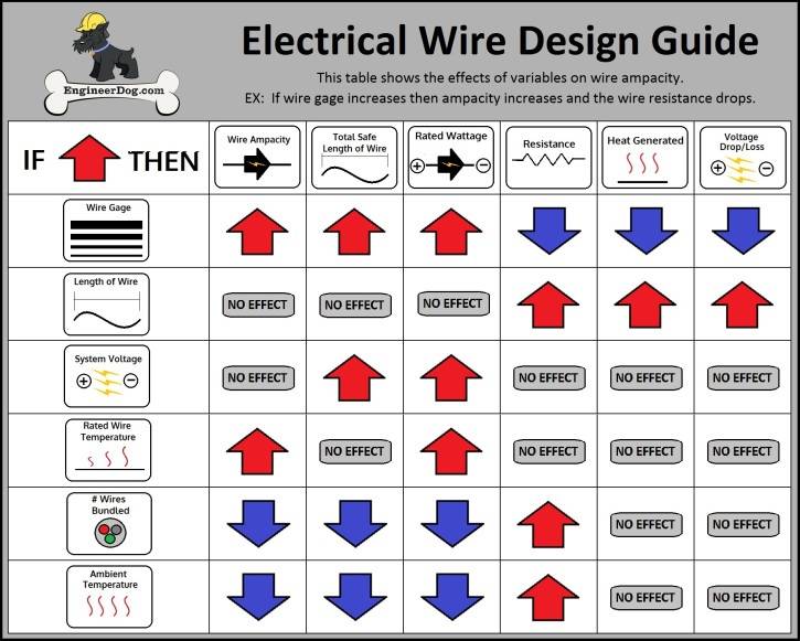

You'll need to figure out what wire gauge to use. Here's a little graphic (interactive at site) compliments of https://engineerdog.com/2015/01/05/free-electrical-wire-gauge-sizing-calculator/
