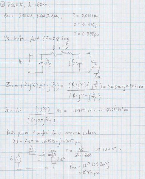

A 230kV, 160km long transmission line has the following parameters expressed on a 230kV, 100MVA base.
R = 0.0151
X = 0.1476
Y = 0.288
The sending end voltage of the line is held constant at 1.0 pu. The load at the receiving end has a lagging power factor of 0.8.
Show that the Thevenin equivalent yields,
[tex]V_{Th} = 1.022 \angle -0.13^{\circ}[/tex]
[tex]Z_{Th} = 0.0158 + j0.15077[/tex]
See figure attached for my attempt.
I'm confused regarding the maximum real power transfer limit.
Is this supposed to be calculated assuming,
[tex]Z_{load} = Z_{Th}^{*}[/tex]
or are we supposed to use the PF of the load stated in the question somehow?
Thanks again!
  • Handwritten engineering derivation on graph paper: a 230 kV, 160 km transmission line pi-model with series R+jX, shunt Y/2 admittances and Thevenin equivalent Zth and Vth, followed by the maximum real power transfer calculation Zl = Zth* and Pmax = 15.84 pu.

While it may seem to be hinting at conjugate matching, as far as power transmission goes that sounds unrealistic to me. Who would be happy to have a load voltage just half of what the power station was supplying? With half of the station's power output going to heat in the powerline? It's overdoing the de-icing just a tad.
Maybe they are asking what power you could get to that load if you used powerfactor correction?
When in doubt, ask your professor for clarification.
