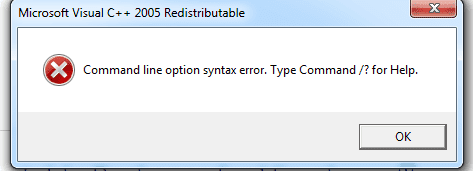

I have downloaded it but it gives an error when tried to be installed. How can I do this now so that I can try to re-install Autocad?
Thank you.

Why does command line syntax error appears when I try to install redustributable?
Thank you.

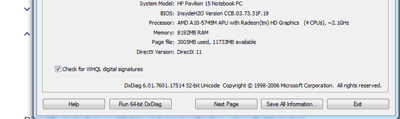

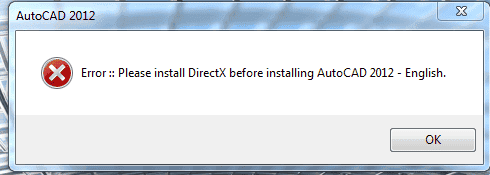

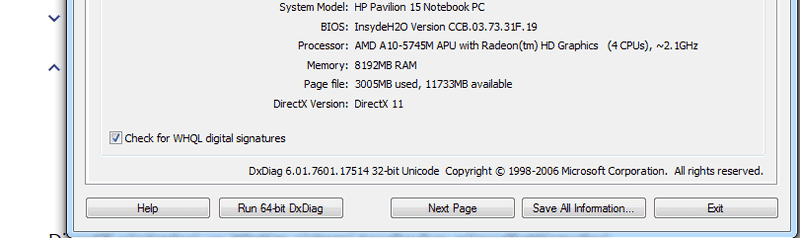

There is a problem again about directx.
But I have directx 11
I have already installed SP 1. What is the problem now?
Thank you.
