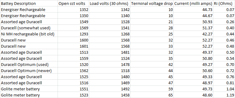

It looks to me like Duracell batteries manufactured here are not up to standard or we are getting cheap imports ?! Dave's measurement above indicates a terminal voltage drop of about 25mV (for a 10 ohm load) and that looks like it's for an old Duracell (could Dave confirm ?) since open cct voltage for a new battery is about 1.6 Volts. Meanwhile my new battery drops about 50 mV from 1595 mV down to 1545 mV across the same (or similar) load.
I would say these numbers are measurable enough - even with an ordinary multimeter such as I have.
Even Dave's measurement is out of spec against the data on the datsheet whereby internal resistance/impedance does not exceed 0,15 ohms. I wonder if they are mistaken in thinking that impedance measuring at 1kHz gives a 'fair' reflection of DC resistance ?

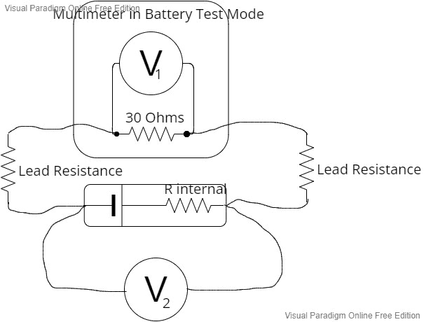

From what I've read online, the key point about 4-wire measurement is not about "4 wires" per se but rather about ensuring that the voltage measurement probes are placed directly across the resistance being measured.
You are correct in pointing out that this is NOT the case when using battery test mode since the probes are carrying the load current going through the (presumed) 30 ohm load resistance within the meter. And hence there's a ##2IR_{lead}## voltage drop.
However it does now beg the question, was there anything particularly wrong with my previous "one meter method" of measuring first battery emf , then load voltage and finally load current? Since here (for the voltage readings) I was indeed placing the probes "directly across the resistance being measured" ie directly onto the battery terminals. And load current went through a separate path to the external resistance.
If, as you suggest, you were swapping the same meter for volt and current measurements, the resistance of the meter would be affecting the current. There's more to this than meets the eye.

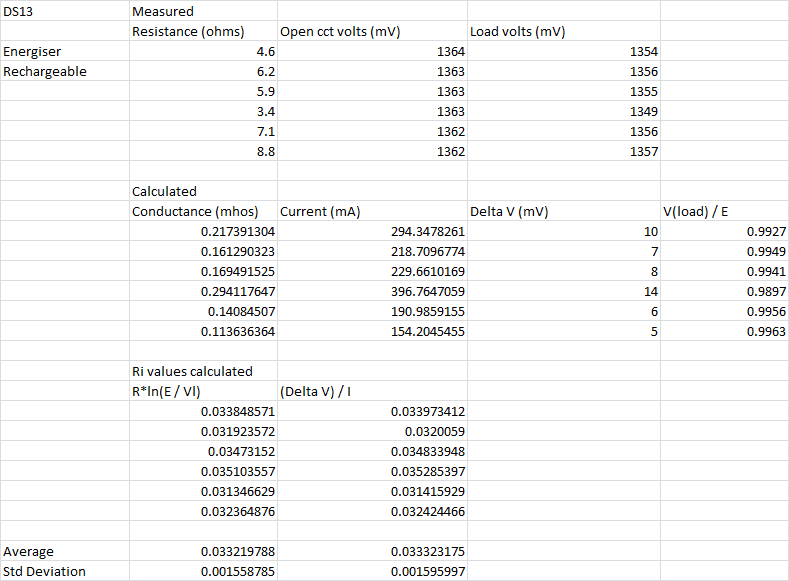

So after all the helpful discussion in this thread, I am finally starting to get some (hopefully) sensible data and results from this experiment. Setup is as per following pic. The first pencil supplies a minimum load of about 13 ohms whilst the second exposed lead enables a set of readings (volts / amps) to be taken simply by changing the point of attachment of the red crocodile clip.
I hope my understanding of 4-wire measurement has improved somewhat. I could not understand the reason for Dave's insulated copper strips but having initially connected negative lead of load circuit to the top of the crocodile clip attaching voltmeter to battery negative , I finally realized what Dave was on about and reconnected as follows:
The circuit is completed by touching the ammeter positive probe onto the terminal at right. I hope it is clear that load leads and voltmeter leads are insulated from each other right up to point of mutual contact on the battery terminals.
Result (from one of many datasets)
Many thanks for all the tips - have learned a hugh amount about the importance of taking into account various small (usually ignored) resistances such as ammeter resistance, lead resistance etc. And of course about 4-wire measurement in general.

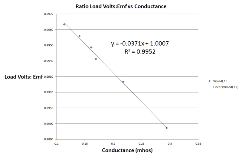

An interesting slant on this experiment is to apply the binomial theorem to obtain an expression for current in terms of conductance: $$I=\frac{V}{R+r_i}=\frac{V}{R(1+\frac{r_i}{R})}\approx\frac{V}{R}\left(1-\frac{r_i}{R}\right)=VG-Vr_iG^2$$ The one term binomial expansion assumes ##r_i<<R## but we can assess the error even with very modestly chosen values of ##R=4\Omega## , ##r_i=0.5\Omega## and ##V=1.5\; V##. Accurately determined current is ##\frac{1}{3}\;A## and using the expression on the right we obtain ##I\approx\frac{21}{64}##. The difference is just ##\frac{1}{192}## or about 1.6% (of ##\frac{1}{3}##).
For the data set graphed above with R ranging from about 13 to 20 ohms, the approximation will be even better. Accordingly we can plot current vs conductance (calculated as ## \frac{I}{V_{load}}##) and obtain the relevant coefficients (emf and internal resistance) from quadratic regression. The plot obtained is also an illustration of Ohm's law since the dominant term in ##VG-Vr_iG^2## is of course ##VG=\frac{V}{R}##.
The statistical 'caveat' of this method is that in applying quadratic regression (using Excel's trendline facility), we force a zero intercept based on the equation having a theoretical (0,0) intercept. I am not sure what statistical 'gurus' would have to say about doing that!
I am a bit concerned about ##R^2=1## (too good to be true ??) but otherwise the coefficients obtained are in good correspondence with the previous graph: ##emf = 1581 \;mV## and ##r_i=\frac{458.56}{1581}\approx 0.29\Omega.##
  • #90
Hellfire. Why ever would you use a zero intercept? Did anyone actually measure that point??
