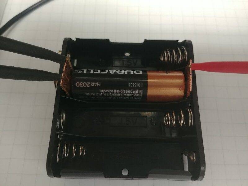

Yes, this. Plus you should review "kelvin contacts" or "4-wire sensing" measurements. You don't want the load current flowing through any contacts that would create an extra voltage drop for your meter to measure. The data you are collecting is what your meter sees (i.e. inside the meter). This is critical for sensitive measurements.

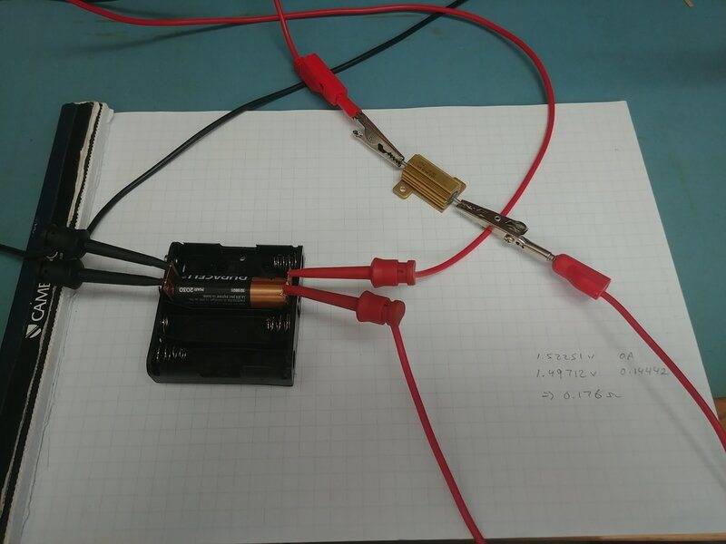

Following is my latest attempt. I am using 2 AA cells in parallel and that is stabilising the readings somewhat at the expense of a more limited range of readings. Some will no doubt quibble that 3 of the 5 readings are 1501, 1503 and 1505 millivolts so right at the edge of the meter's resolution. I take Tom G's point about the battery holder but it's new, the springs are strong and overall it enables more solid connections than probes direct onto battery terminals.
As part of the brief is using a "home-made" resistor one pencil lead supplies 8.8 ohms while the other is used as a variable resistor (depending on where you attach the crocodile clip) enabling the 4 other readings.

Yes - I'm aware the range of load voltages is very small - only about 25 millivolts in the last graph I posted.
I think the systematic error in resistance is indeed mainly due to ammeter resistance - many thanks for pointing that out. Will use the regression obtained offset value (y-intercept) to correct the measured resistance value.

I'll try to improve on the connections as per your suggestions above.

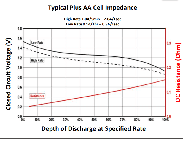

I have been experimenting on various Duracell Plus AA batteries. In light of the following information from that particular cell's datasheet, I rather wonder if I'm not trying to measure something that doesn't exist or is too small to be measurable ??
The relevant datasheet can be found here and it states 65 milli ohms "impedance" at 1 kHz. ie 0.065 ohms!
DC resistance varies with DOD (depth of discharge) as per graph below but seemingly does not exceed 0.15 ohms.
